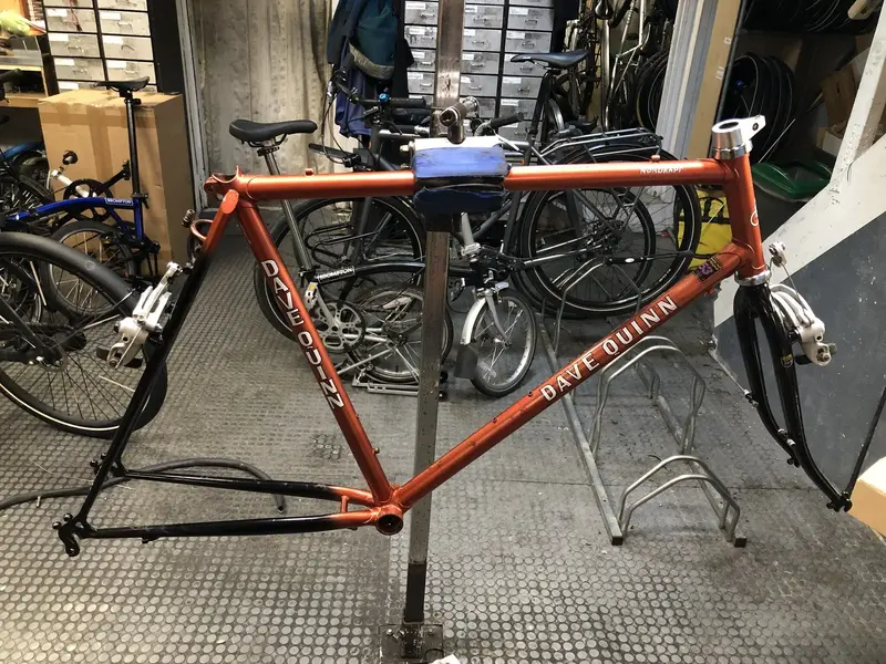

After everything else came out without drama, it’s onto the frame…

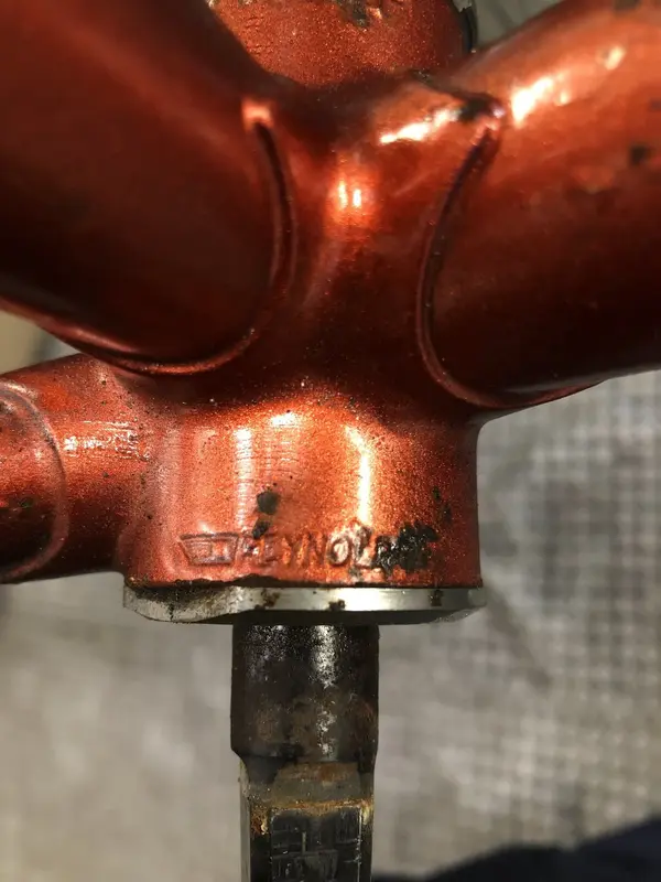

Despite looking pretty fresh and healthy from a distance the frame has some signs of aging, as to be expected from being around for over 30 years, albeit mainly standing in a garage. It’s structurally sound and free from dents and scratches, but it has a fair few spots of rust. It isn’t too bad, and I do like a nice patina, but I would like to make sure it won’t spread.

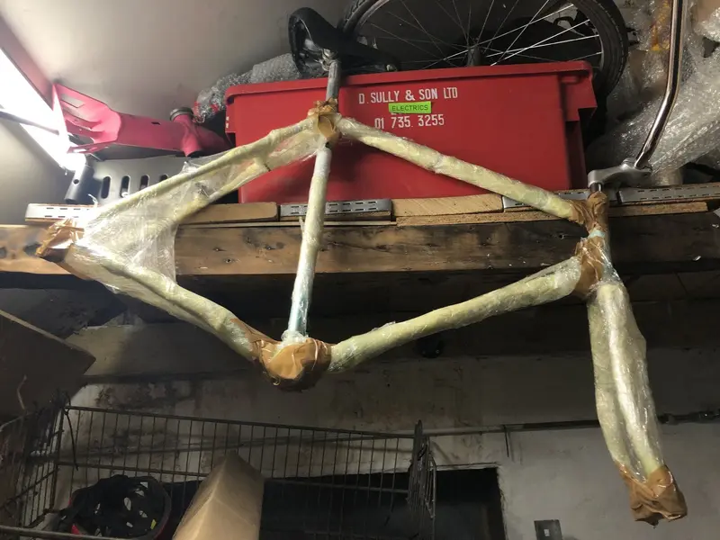

I bought a gallon of Evaporust a while ago and it worked great on a rusty Roberts stem and some hardware, so I thought I should try it on Dave. As I don’t have enough to fully submerge the frame in it, I’ve tried the paper towel and cling film method. Here’s a picture of another frame I’ve treated the same way:
It did a good job of the one above, but unfortunately Dave’s scars remained the same, which makes me think the rust is under the lacquer. It also dulled the clearcoat a bit as I’ve left the dressing on for a tad too long… Oh well… You live and learn. Time to order another gallon of the stuff and give the frame a nice bath.

Evaporust is good stuff. The decals on both frames that I’ve treated with it seem unaffected, but good point as it’s something I’ve not really thought much about. The other frame came up real nice, all of the rust magically disappeared. It turned black, but a bit of gentle scrubbing with fine wire wool soaked in GT85 revealed lovely raw steel.
I might try to plug the bb, tape the vent holes etc and fill the frame. I will report back soon.
