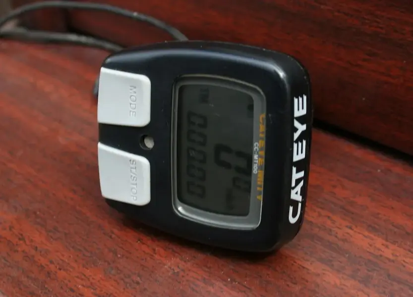

Almost forgot a small gem that arrived with this Kona. An original Cateye Mity in mint condition.

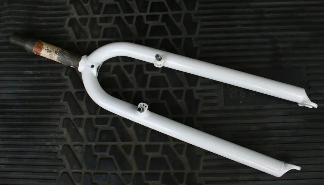

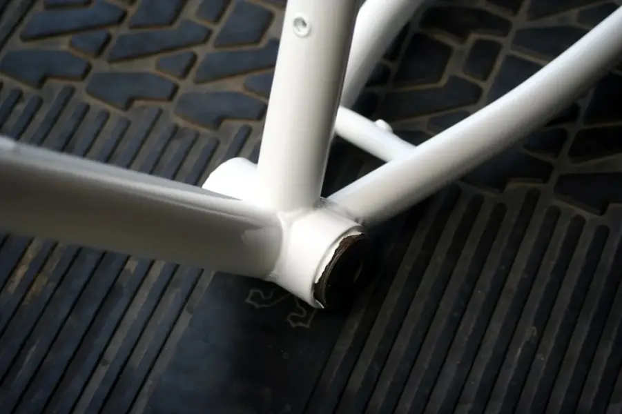

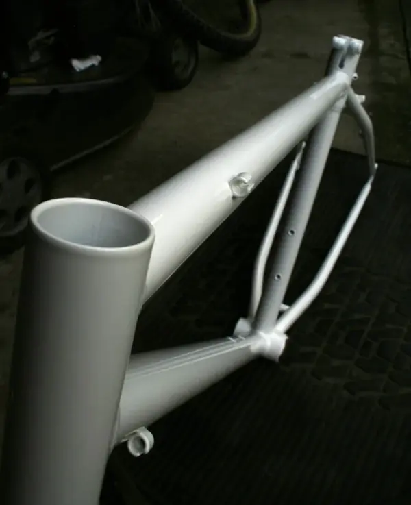

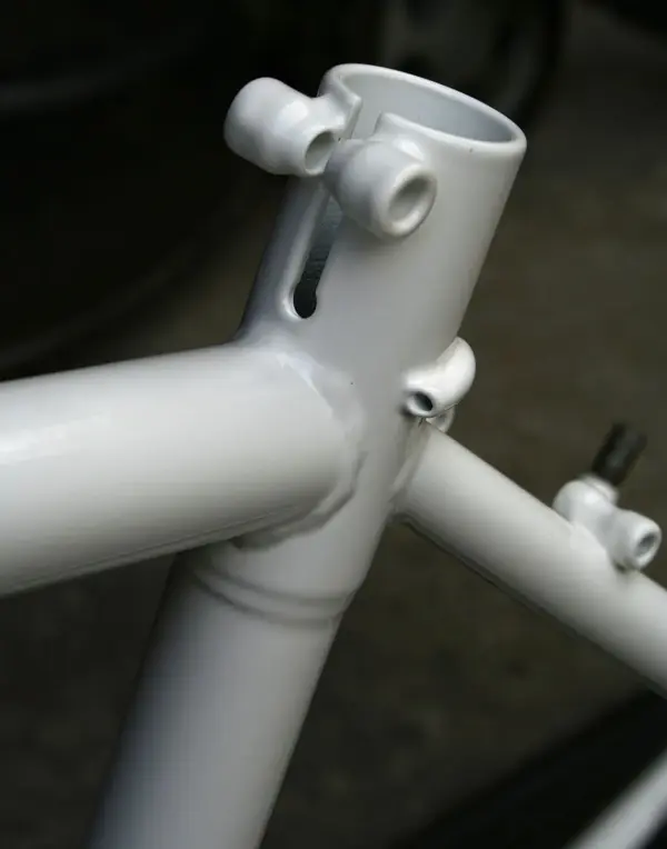

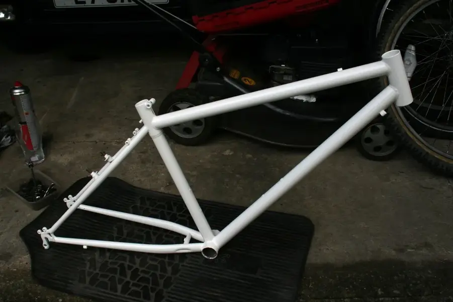

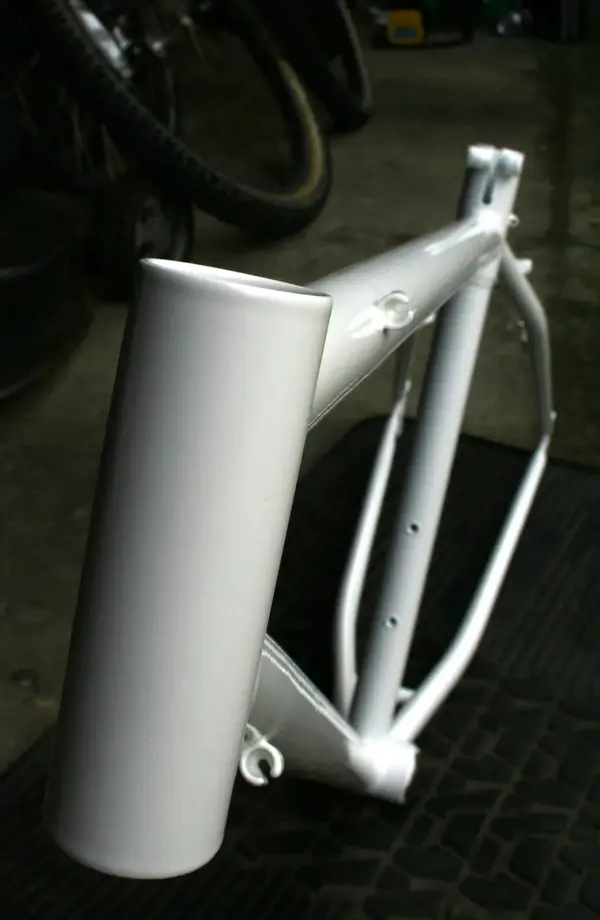

The frame and forks are back they look really amazing with a very smooth glossy finish. The quality of the powder coating is very good. The only niggle is the finish around the BB which needs tidying up. it was requested that the cups were left in to protect the BB threads during blast and paint. As the BB was quite badly pitted I elected to leave the original Suntour cups with the frame.
Just waiting for the decals to arrive from Gil and then the rebuild of the Araya RX-7 rims can start.
I must admit I'm very impressed with the finish especially as it only cost £35 to transform a rusty scratched frame into this.

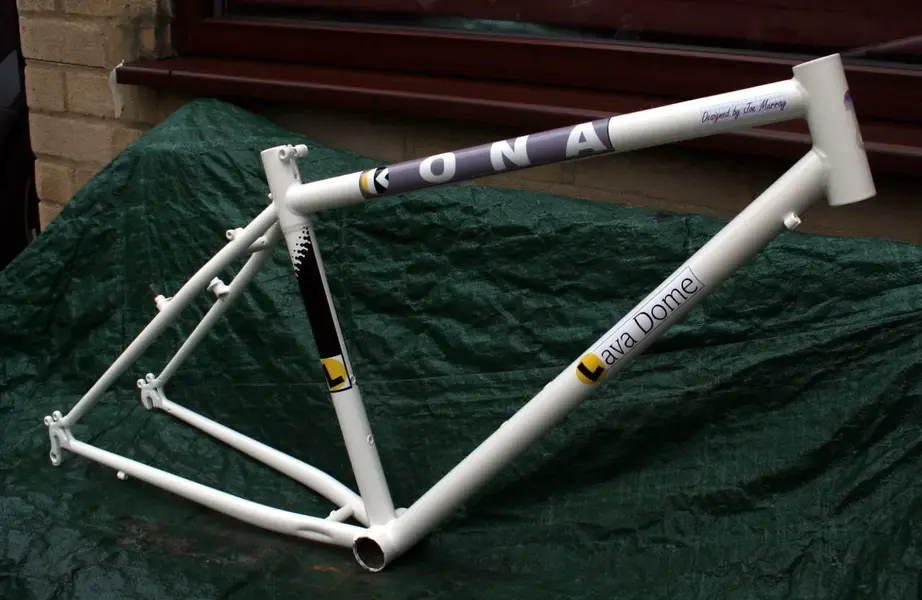

Decals arrived from Gil today, thanks Gil.
