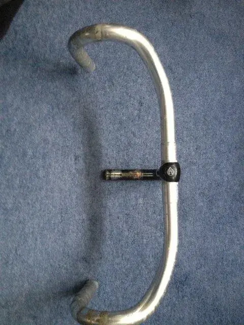

I've now got almost all the components I need to complete the build - there's one minor detail that I'd like some guidance from the community on.
What handlebar tape should I be using ? :-) Here are some pics of the period 130mm XA, and the cinelli crits I've sourced.
I'm taking my time considering final details - I'm going to savour the remainder of the work as the bulk has been done.

Looks like it could have been Benotto tape which you can still get NOS in yellow

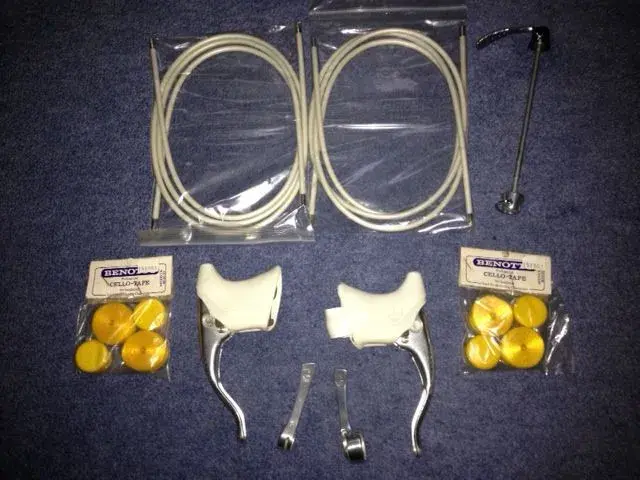

I'm an excited retrobiker tonight - my package finally arrived, full of swag.
Two reels of Benotto tape and plugs
Two complete sets of campagnolo gear/brake outers in Pearl white
Synchro Levers
Rear Q/R Skewer
Brake levers with White hoods.
I'm very impressed with practically everything - the white hoods on the levers are nearly flawless. I don't intend to use the levers, so those will be sold on, they're in very, very good nick with just a little rub on one of them, but they're not original and they don't have the hex key adjuster.
And I've spent ages polishing the old ones up!
There are an inordinate amount of bits in with the synchro levers - if anyone can refer me to a diagram showing the right assembly order I'd be very grateful!
Rear skewer is good, but the static nut side doesn't quite match the front one - it has two flat edges to it, rather than being just round, but it's still progress from the Tacx one !

Don't forget the thin washer that fits inside the body of the shifter under the Syncro insert and a smear of oil. Watch out when you install the Syncro insert too as those two springs can become a bit tired with age, I broke both springs in my shifters the other day without really trying. I took a chance though and ordered some springs that were advertised for 8/9 speed Ergos and they are the same, Campagnolo part number SL-RE009, loads on Ebay but all in the USA it appears. Mind you it was a blessing in disguise as the new springs give a much more positive click in each gear, before you could barely feel the resistance at all.
