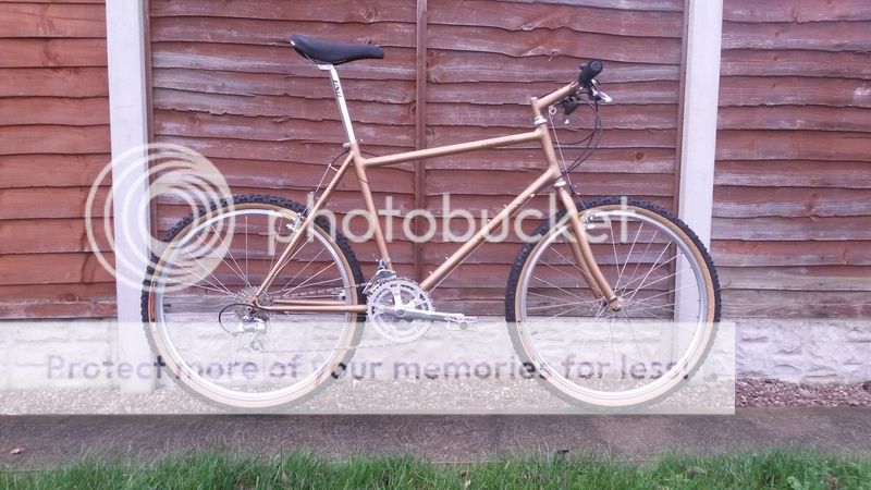

Pedals, why sell old to buy new for an old bike??? Cleaned the kkt's from my s&g and drilled some lube ports as i cant remove the plastic cabs without buggering them. Ones fine but ones stiff so loadsa socking with oil tonight. Theyve cleaned up okay but i feel they suite the bike well....????
All bolted together now but needs some proper fettling and setting up before i call this one finished.

well, its finished, needs a few tweaks to improve the brakes and fine tune after the cable have strecthed a tad. ordered some helicopter tape to protect a few vunerable areas and fingers crossed itll be here early this week....
spec is:
frame - 1989 overburys pioneer
fork - tange copy
headset - shimano 600/ultegra
stem - overbury
bars - kalloy uno (new)
grips - foam superstar with tioga plugs
post - kalloy uno (new)
saddle - selle italia turbo
bb - contec 127.5mm (new)
crank - shimano deore mt60 with shimano biopace rings (new bolts)
chain - kmc 8 speed (new)
pedals - kkt flats
mechs - shimano deore xt m732 front and rear
shifters - shimano deore xt m732 thumbies
cables - all new inners and outers
levers - shimano deore mt60 2 finger
cantis - shimano deore mt60 with shimano yokes
qrs - odyssey wheels and seat clamp
tyres - irc mythos xc
rims - mavic 217 sup
tubes - halfords (new)
spokes - dt ss plain gauge
hubs - pace rc50 front and hope ti-glide rear
cassette - shimano hg41 8 speed 11-30 (iirc)
think thats it?
pics to follow
