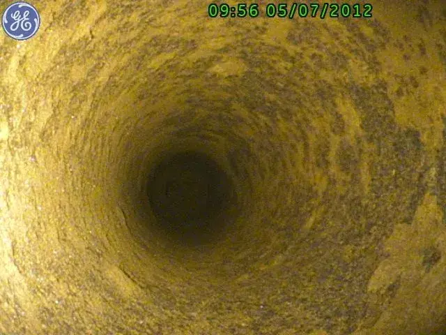

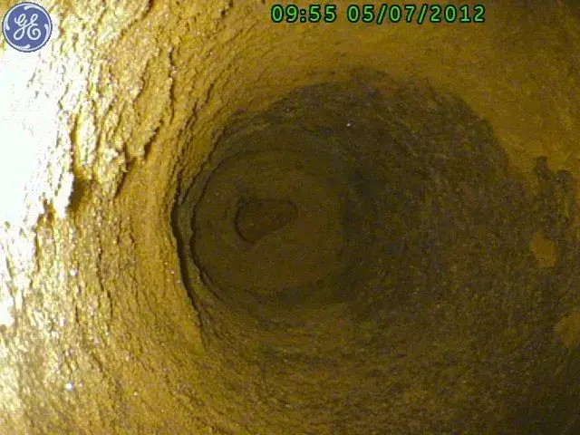

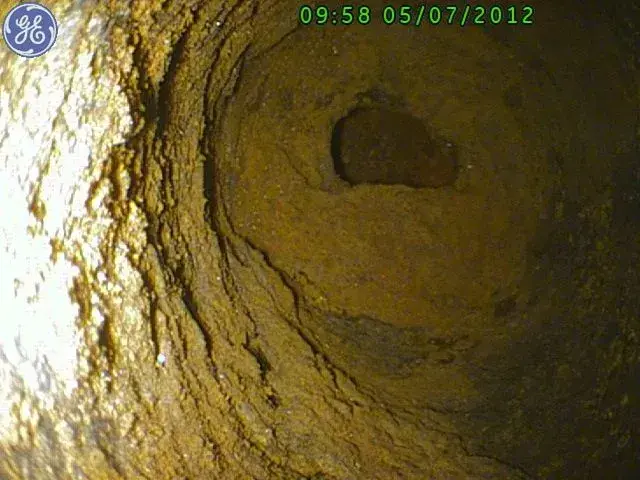

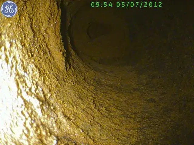

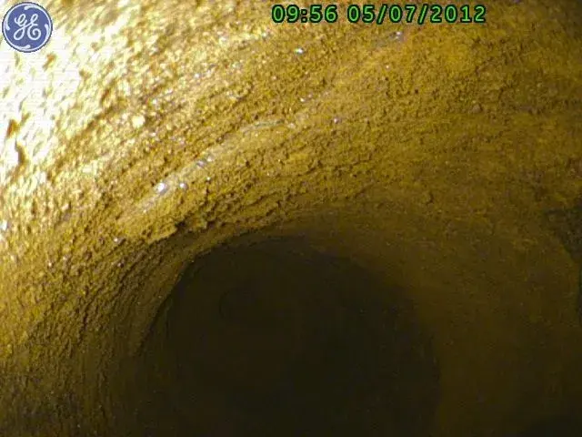

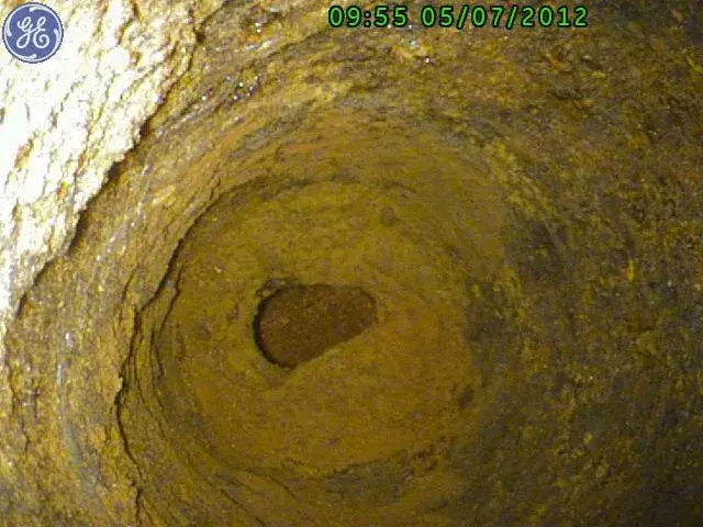

Did the video probe inspection today.
Not good. Corrosion is bad - especially in the lower inch or two.
Good news I can buy a Prestige seat tube so it's getting a new one :D
We have found the source of the corrosion and the cracked seat clamp - some numpty has inserted a 26.8mm seatpost into a 27.2mm seat tube and wound it up until it held. This has distorted the seat tube collar and allowed a way in for the water - the distortion is another good reason to replace the seat tube.
Less good news on the paint - not available anymore :( Carl I'll drop you a PM re: the stuff that you have or Kevin is going to experiment with mixing.
So that's it now for 3 months.... Kevin is going to e-mail me pics of progress so I'll post them as I get them - roll on October!
