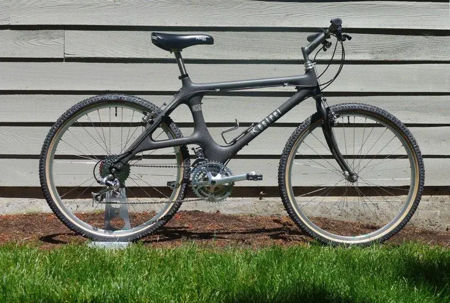

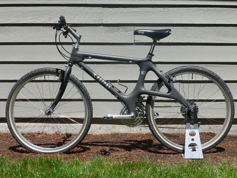

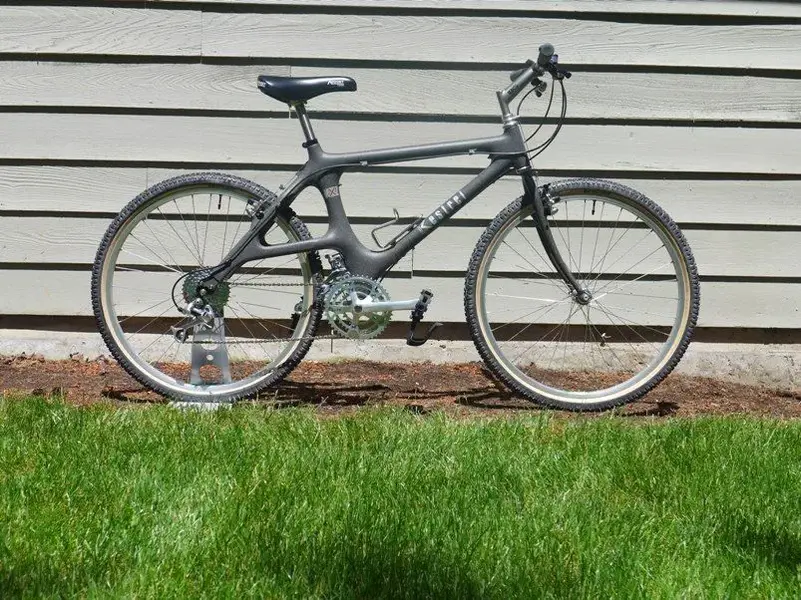

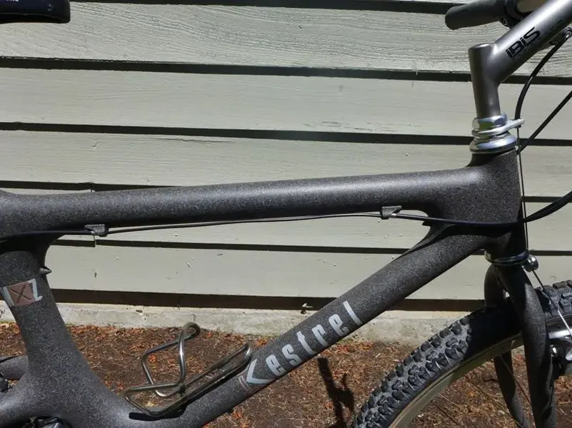

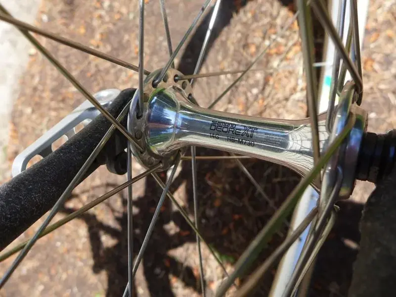

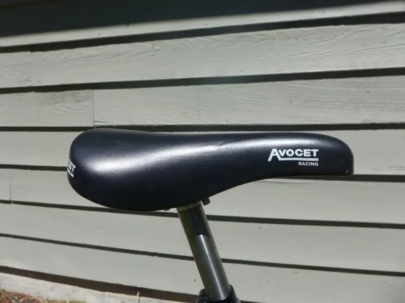

I finished this some time ago.

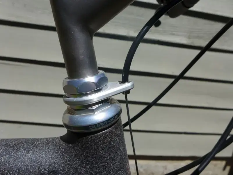

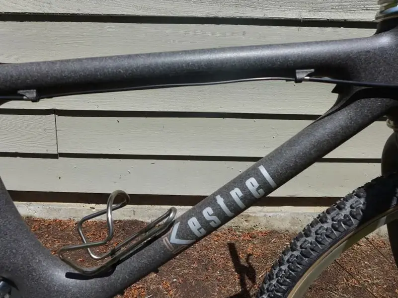

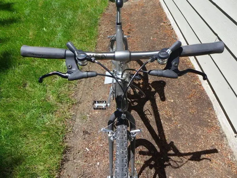

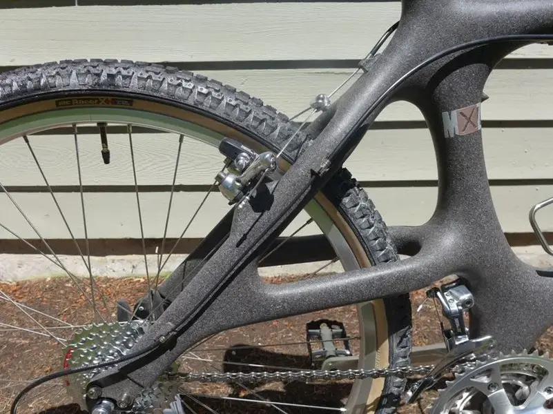

I went in a couple of directions for this build. It was sold as a frame only so I figured I could take some liberties with the build.
First: Used a lot of titanium parts - replaced all the bolts with ti bolts and put as many titanium parts on without it being too far from a period build.
This frame has a number of bolts to attach things to the frame: Front derailleur, rear drop outs, 2 water bottle mounts so those are all now titanium.

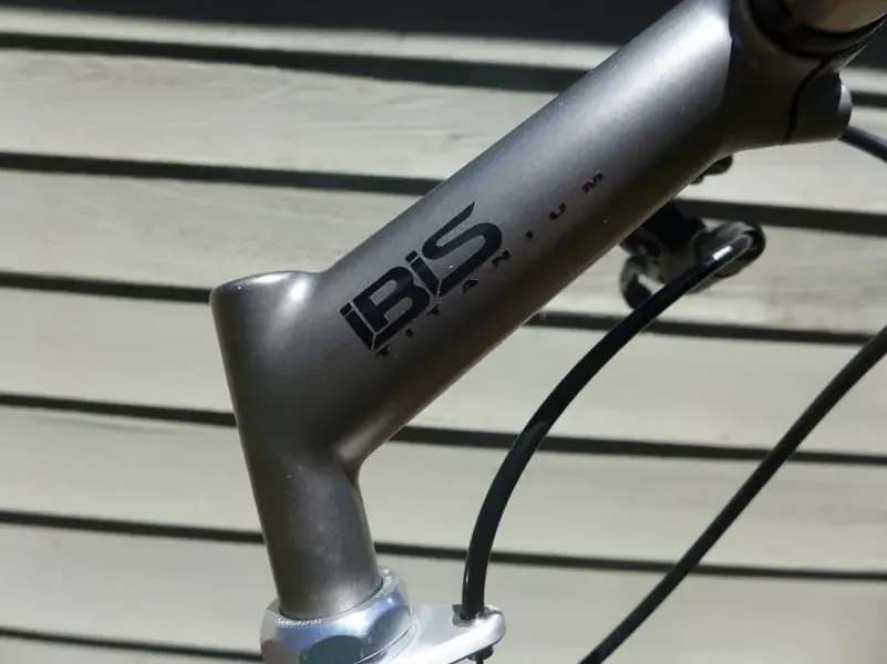

Second: There were a number of bird names used by bike component companies so the decision was made to use as many as possible, again sticking as close to a period build as possible. Names are: Kestrel, Merlin, Ibis, & Avocet. Now known as the bird bike.
Frame: Kestrel MXZ Carbon Fiber with original Zolotone granite finish
Fork: Steel with original Zolotone finish
Headset: Shimano 7400 Dura Ace
Stem: Ibis titanium

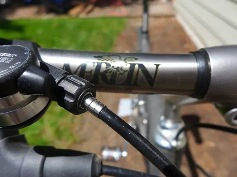

Handlebar: Merlin titanium
Grips: Ritchey
Brakes: Shimano Deore XT
Brake Pads: Shimano Deore XT
Brake Cables: Shimano Deore XT
Cantilever cable hangers: Shimano
Brake Levers: Shimano Deore XT
Shifters: Shimano Deore XT 7 speed
Front Derailleur: Shimano Deore XT
Rear Derailleur: Shimano Deore XT
Derailleur Cables: Shimano
Cassette: Shimano
Chain: Shimano XT
Cranks: Shimano M730 Deore XT
Crank Bolts: Ritchey titanium
Chainrings: Shimano Deore XT
Bottom Bracket: Shimano Deore XT
Pedals: Shimano Deore XT M731 (for pics) or MKS Grafight 2000 (for riding)
Hub Skewers: Ringle titanium

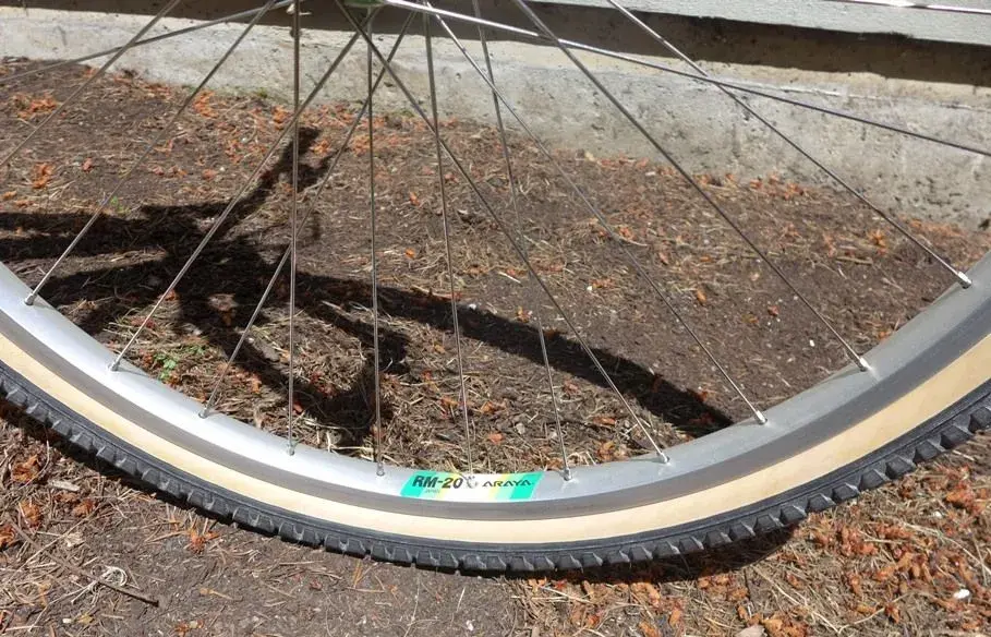

Rims: Araya RM-20
Hubs: Shimano Deore XT

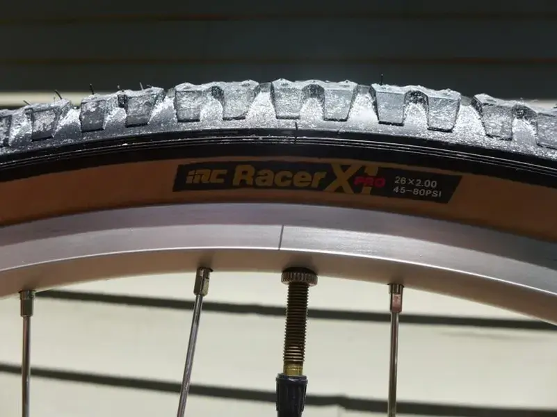

Tires: IRC Racer X Pro

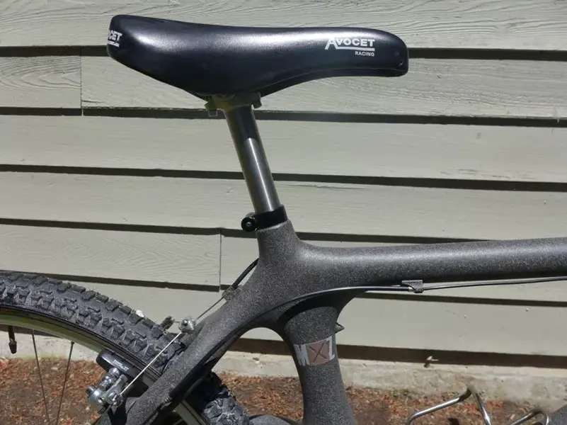

Saddle: Avocet Racing
Seatpost: Syncros titanium
Seatpost Binder: Kestrel
Bottle Cage: King titanium
All hardware bolts: titanium
Weight with MKS riding pedals: 25.1 pounds (11.39 kg)
The first 2 photos show the bike with pedals for these fancy photos ...the third photo shows the bike with riding pedals (MKS Grafight 2000).

Re: 1989 Kestrel MXZ - Carbon Fiber - Zolotone
That's a crazy bird :) i like the built up concept !
With this surface of these frames it' seems like a sculpture !
Nice, very nice but I thought it maybe lighter my 20" Xizang is 10kg with no to parts only frame
I love these old Kestrels. Cracking build and love the concept behind it!
