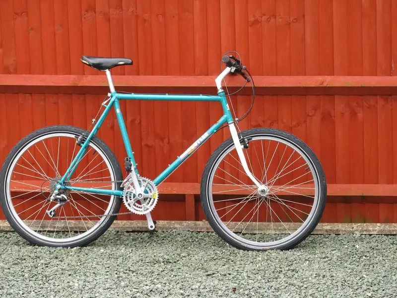

Hi everyone,
Just joined as I have been lurking here for a while. Ive got my Claud Butler Pagan rolling again.
Make: Claud Butler
Model: Pagan (Model 989)
download/file.php?id=166904
Model Year: 1989
Colurscheme: Aqua Blue & White
Frame: Reynolds 500 All Terrain - (Lugged)
"A strong and durable set utilising plain guage chrome molybendium tubing for the economically priced all terrain bicycle" - Claud Butler 1989 Brochure
Fork: Unicrown
Headset: Sealed 1" threaded
Stem: Kalloy AL222
Handlebar: SR MTB - Steel
Grips: Kraton Black
Barends: None
Brakes: Shimano Exage Country Cantis
Brake Pads: Generic V Brake Pads
Brake Cables: Unknown
Cantilever cable hangers: Standard
Brake Levers: Shimano Exage Country - Integreated with thumbshifters
Shifters: Shimano Exage Country SIS Thumbshifters (Switchable Indexed/Friction Rear)
Front Derailleur: Shimano Exage Country
Rear Derailleur: Shimano Exage Country
Derailleur Cables: Unknown
Cassette: Shimano 6spd SIS
Chain: Black UG
Cranks: Shimano Exage Country 175mm
Chainrings: Shimano Exage Country Biopace: 28-38-48
Bottom Bracket: Shimano UN55 - 122mm
Pedals: HTiPO 3
Rims: Rigida Rally 30
Hubs: Small Flange Alloy Mallard Diabolo Sealed (QR Front)
Nipples: Alloy
Spokes: 14g Rustless
Tyres: Continental Comfort Contact Reflex -(Original Fit 26"x1.62" Skinwall)
Tubes: Decathlon - Schrader
Saddle: San Marco Rolls - Black Leather (Original Fit = Viscount)
Seatpost: SR Micro Adjust Alloy
Seatpost Binder: Generic QR
Weight: 13.92Kg (30.68 Lbs)
