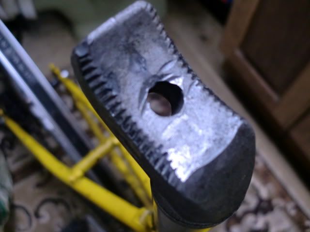

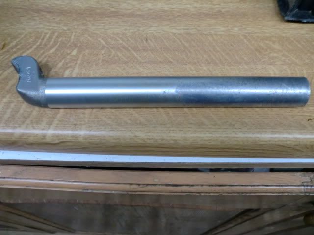

Well, i made a start on it today. I knew that seatpost was stuck - so made trying to get it out the first job. About an hour of "gentle coaxing" first with a rubber mallet, a bit of frustration, some choice words then followed by a few gallons of WD40, a bit of wiggling and some heavy duty whacks with a proper
hammer it finally started to free off.....
It was pretty well seized in there, the top of the seatpost suffered some battle
scars, but nothing too bad - the grooves where you pivot the seat to adjust it were fairly worn but still hold the seat tight so it should be ok to use.
I'm glad i can now adjust the seat height - about 15-20mins into the job i started to think i'd never get it out!

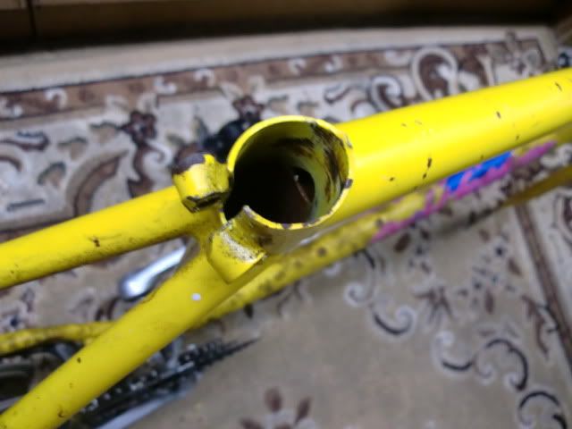

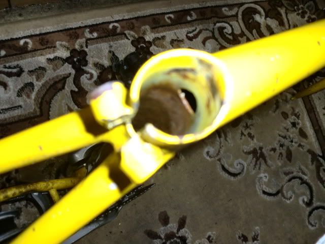

The seatpost seems to be alloy but had quite a bit of rust on where it had fused itself to the steel inside the frame, so i cleaned it all off with a wire brush followed by some fine steel wool. Here's a few pics -
