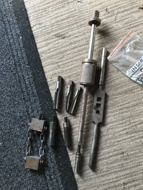

I have the full slide kit here. Complete with taps and bolts. You saw off seat mount tap the tube and screw in bolt attached to end of slide. Very effective. Only had to resort to caustic on one occasion. Where are you?

Hi this is a custom made kit from weeman on here. All bespoke and hefty not for the faint-hearted Three sizes of tap and insert to fit all posts.
That’s a lovely bit of kit, so need to get my lathe working so I can make one! My brothers just given me a frame with a stuck post and pretty certain it will come out with a bit of freezing and slide hammer action! 🤞
