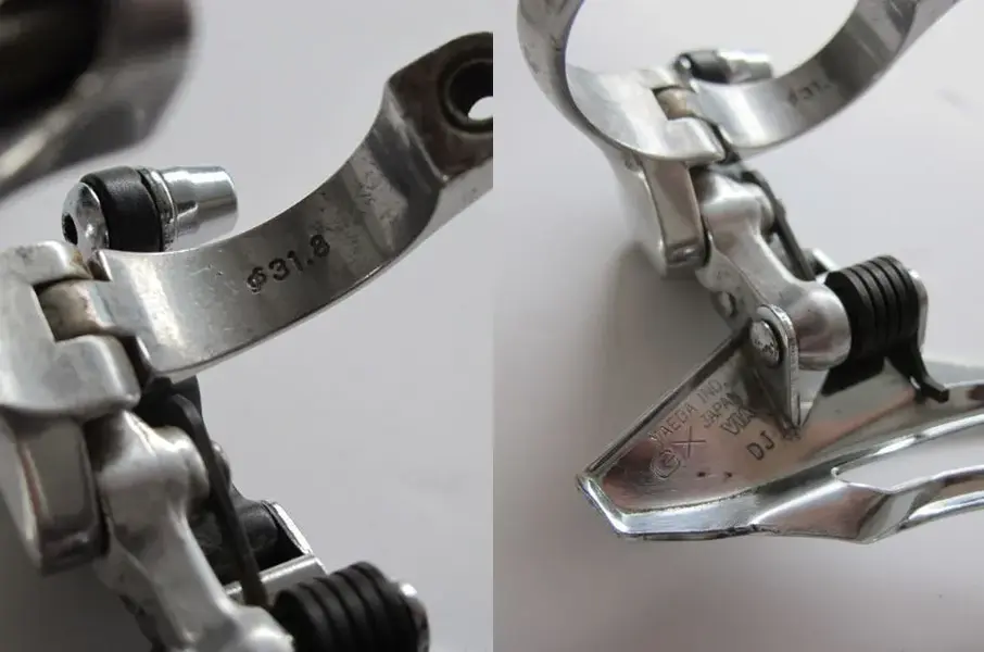

Thanks, spotted this lot today during my morning eBay scan. I'm pretty much there with all the components it's just the brakes and mech to sort. I'm now fairly certain that Suntour did make a 31.8 but they just didn't advertise them, which is going to make finding one fun!
Re: Suntour XC 9000 (I'll now consider anything!)
I have a Suntour XC 9000 front derailleur in 31.8.
I'm in California.
My thread.
It looks a little grungy in the picture, but I have cleaned it up since then.
I'm in California.
My thread.
That solves that mystery then :D. They did make them but didn't advertise them. Any chance you could send me some more pictures?

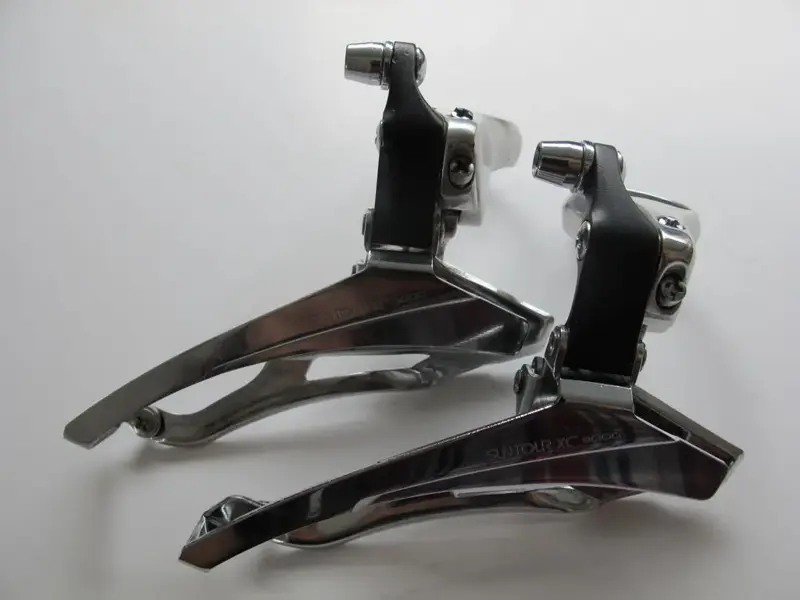

Sen's front mech has arrived and there's no doubt that it what I've been after :D. It's date stamped 1987 (D), October (J) and I've put some pictures up of it compared to my Ø28mm. But why would Suntour choose not to tell people this? I guess we'll never know.
Anyway all I need now is some parts for the roller cams and I'm finished. I think I'll change the title of the post.
