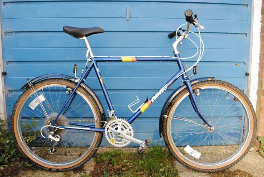

If the front of the bike is riding light it's more likely a fit problem that the bike itself. It looks small for you - how is your weight distribution on it?
Re: 1987 Dawes Cougar
Fairly evenly distributed over the rear reflector! :lol: Looking at the pics, the risers and high stem dont help and the seat is quite far back. Fit is pretty good, it gives me plenty of standover height for the undercarriage.

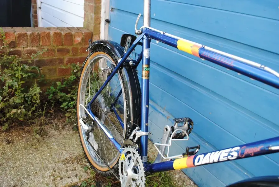

Heres an update and proper post Peaks pics
