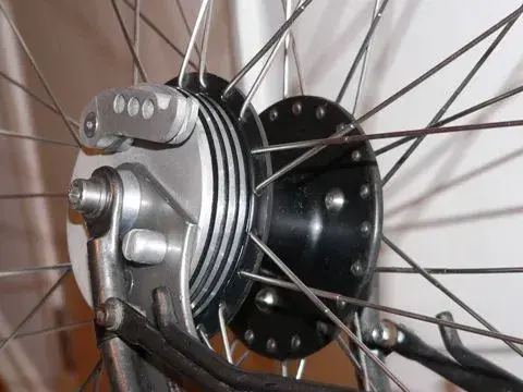

Brakes: Dave Wrath-Sharman swing cam (SC) drum brakes. Custom made and updated to SC Mk4 spec in 1990.

Hubs: Dave Wrath-Sharman Mk4 marine spec anodised. To quote DWS - "they cost me a fortune"

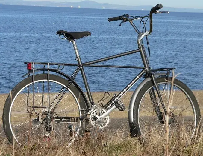

Very handsome, it is a great looking if unconventional bike. I love the horizontal line formed of the crossbar and racks.
Thanks for your comment. There are actually two narrow crossbars in there. Here is a pic up that shows them.
The rear rack is a thing of absolute beauty. DWS made it. The front rack is a later bolt on addition and quite nice quality.

kaytronika":3ps6wvz6 said:
An interesting piece of work... What does it ride like?
Cheers for that. Here is a wee write up I posted on Retrobike:
Hi folks, just back from my first outing on the Highpath. It was just a gentle ride around the cyclepaths of Edinburgh and Leith to see how the bike performed and sort out any glitches.
Jumping on and riding away I was immediately struck by the riding position. It is high and upright, but very comfortable. The bike is short too and handles beautifully.
The brakes are simply amazing, plenty of initial bite which sheds speed very quickly, but in a very controlled way. They certainly give you a lot of confidence. The Yamaha levers are perfect, not too long, not too short and they give plenty of feedback.
The gearchange is silky smooth and I was chuffed that it didn't require any tweaking. No dramas there.
I have to say that I found the Brooks saddle really comfy and it feels like you could pedal for lots and lots of miles in comfort.
The Nokia SL-35 tyres running 15 - yes 15 psi, are uncannily quiet and absorb all the lumps and bumps that you usually feel in places you don't want to.
The handling is very predictable and despite the apparent high centre of gravity it's a solid platform, especially when you are up on the pedals. Geoff Apps and David Wrath-Sharman sure do know their design onions. Highpath is a strange beast to ride, the thing feels alive and eager - it has something, some weird quality or synergy that creates an almost perfect symbiosis between man and metal. (sorry girls!)
All in all I am very pleased with the Highpath, and it's great to see the puzzlement on other cyclists faces whenever I stopped to take pics.

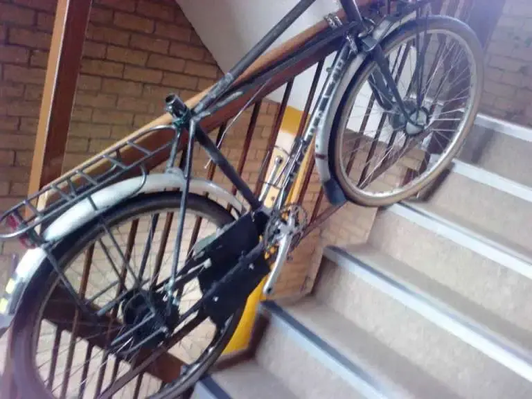

And here is how it looked when I found it:

Oh, I remember seeing the thread on this in MTB Chat, didn't realise it was the same bike. Definitely agree that it fell in to the right hands! Really happy that you managed to get it back in one piece.
Thanks for the write up on the ride style.
