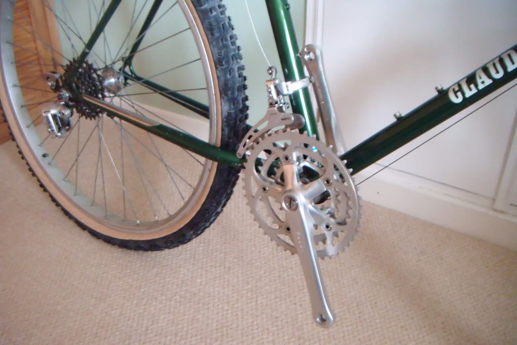

4 days of soaking in oil, a few swift hits with a mallet, iron rod clamped to the seatpost, stand on iron rod and gently twist and pull frame upwards....
Huzzah!!
Nearly there now, :)
Just need a seatpost, chain, and set-up the cantis...
Oh, and regrease the pedals.
It's been a great project to work on as after uncovering all the grime, dirt and grease underneath she is in lovely condition. Am looking for a matching green touch-up paint to put the icing on the cake. Not many scratches but enough to warrent at least a bit of rust prevention..
Here are a couple of latest pics... (just quickies on the phone)
