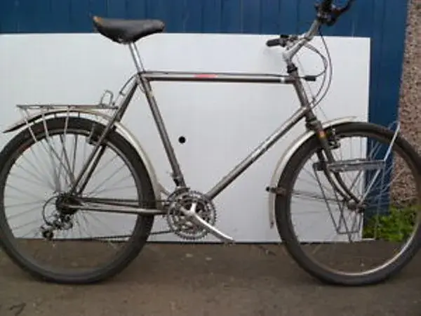

Thought I`d share this one with you guys on here.

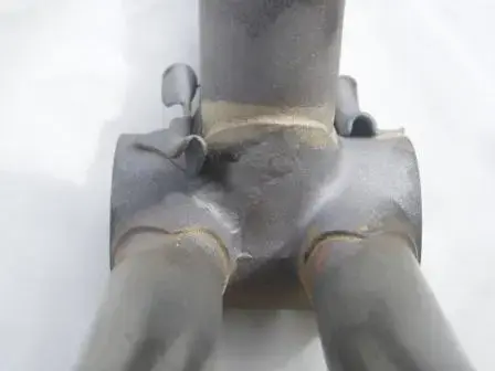

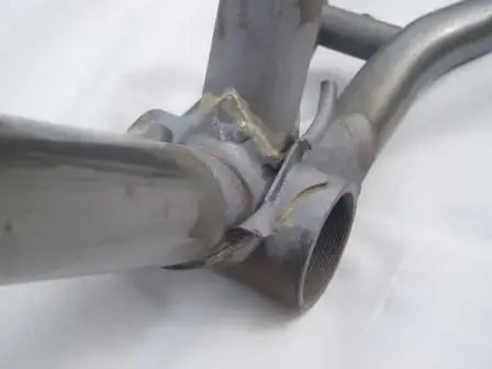

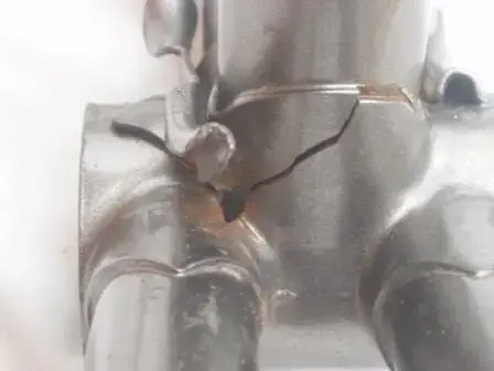

I got this vintage Stumpy from the bay`( photo way below !! ), but it came with a major flaw............the BB shell was broken , not cracked as described in the listing, with the seat tube being completely loose.
The first two close ups give some idea of the problem. First of all I gave it a light bead blasting to clean the area. The next step was to repair the actual shell, this was done by TIG welding. Next I re-brazed the seat tube back into the shell, then another little bead blast to clean up again. The last two close ups show the job to date.
