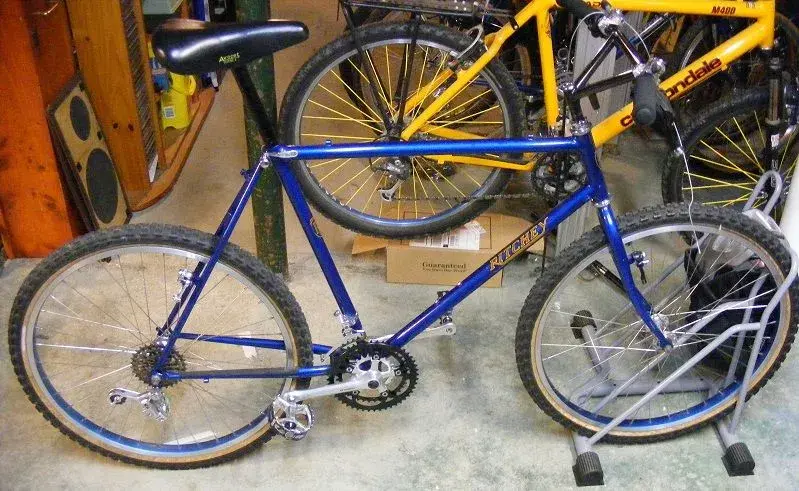

1984 Ritchey Timberwolf. All together, time to test ride!

Lovely bike, but you have to change the grips.

Stumpjumper1990, I know they are not the 'correct' grips-I'm going to be using Grab-Ons from First Flight if they are still available. When riding I do not like mushroom grips of any style. Right now the build is just parts I had on hand, there is a lot to do.

Agree on the grips. Hard to go wrong with the Deerhead build. It would drive me crazy not having matching wheels. Those black brakes are the cats meow, worth searching out a matching set. The paint looks great. I think you are safe with those Spec. bars unless you have the opportunity to come across a filet brazed set someday. Strong makes a cool black seat post that would work for 1984. Possibly black Sugino rings also? Figuring out the year of a early mid 80's Ritchey is tough. The thumbies are funky, how do they feel? I have some filed Suntour Mighties, but don't think I have ever seen that done to the early Shimano.

Those rims look like they were made to match that bike! 8)

Ductape, the thumbies worked really well for me, I have large hands. Cool mod! The wheelset is bizarre, 600 rear hub, 730 front, and late 90's rims, not right for anything. The blue set isn't perfect but will be very good for a rider. A Strong seatpost would be perfect. I'll probably run a black Kalloy until I can score one.
I'm leaning toward an early 1984 build date for this bike. The cable guides are bullet shaped, and not slotted, aside from the top tube. Front derailleur cable routing is above BB, RD is below. The '83 MountainBikes catalog lists a Sugino AT crankset for the Tam, for '84 it's called the TimberWolf, and used a 600. I believe the press-fit BB indicates pre-'85 as well.

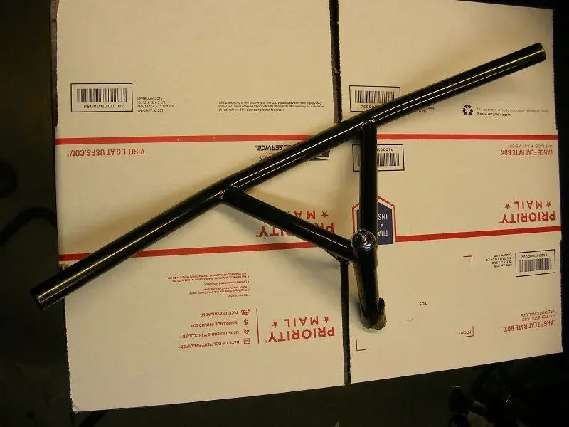

Alright-this project hit the back burner a bit, warm weather hit and the reality of spring household projects took over. I did manage to score my ideal set of handlebars from ebay a couple weeks ago:
Black anodized, Nitto made, Ritchey Mountainbikes stamped, 1983 era, low rise...perfect for this build. I was a bit shocked they came up. The seller also had Magura grips I would have loved, had I noticed in time. Also period tires, and black M700 shifters! No room in the budget for those after springing for the bars, unfortunately. No great loss on the shifters-I like using the originals, especially since they had been cut down. Tires and grips though... :(
With the bars in hand, my interest was rekindled. Time to prep!
Polished and ready:

Fantastic build. Don't know how I missed it first time round but glad I've found it now.
Those bars look brand new. Great score. I think black shifters would look good too. Those cut down ones look a bit funky to me! :facepalm: Not sure how common black M700 shifters are. I'd never seen a set until I bought the ones for my Aventura. Blue rims look good to me too, and era correct as well. 8)
