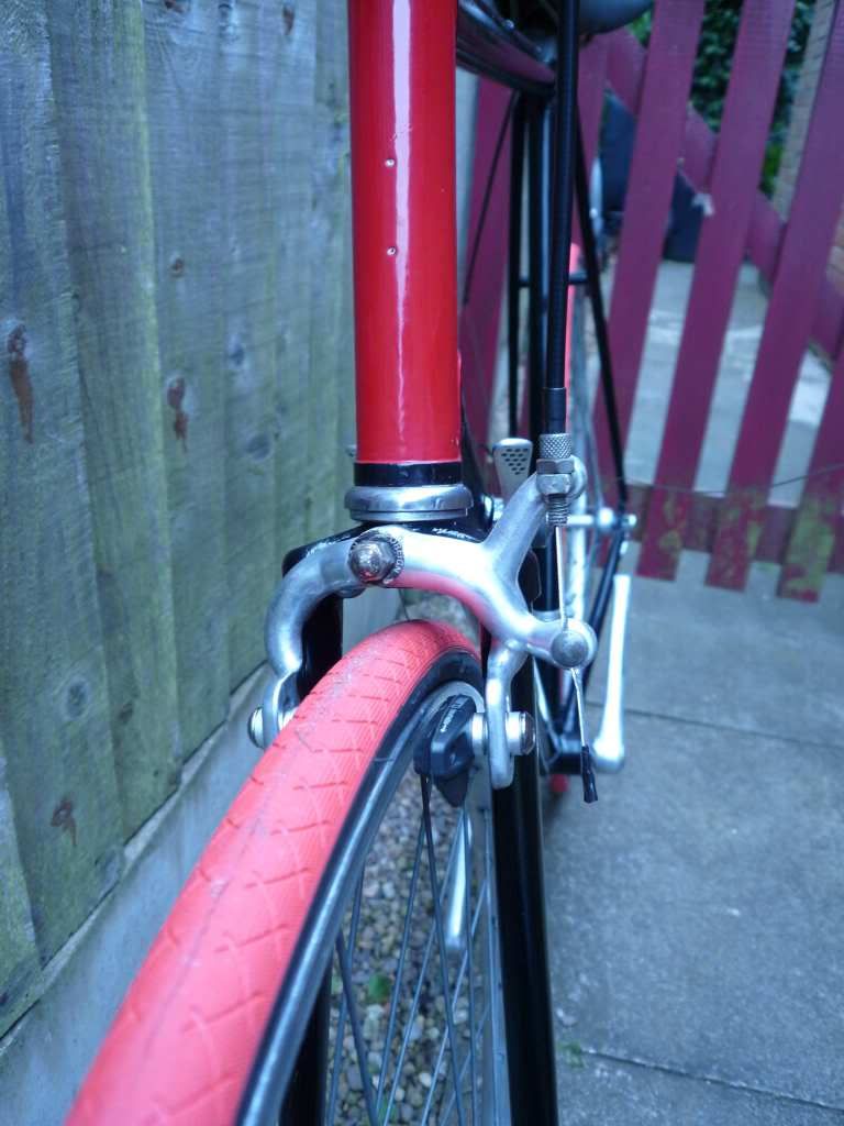

original wienman side pull brakes

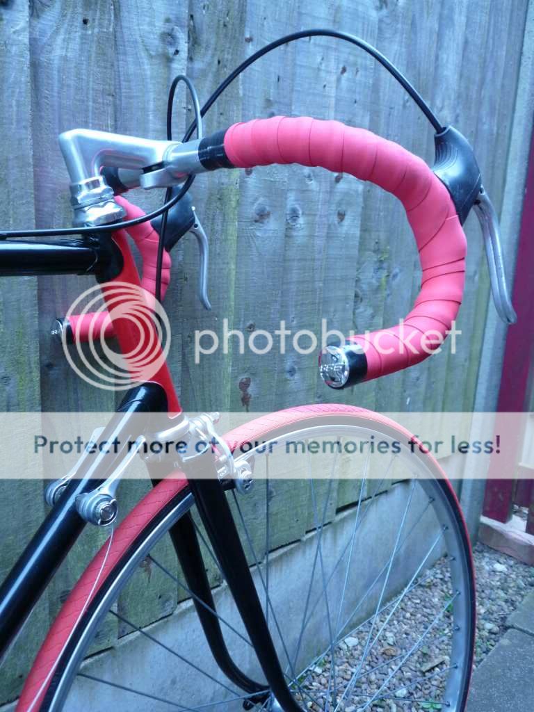

Original bars and stem with Raleigh stamp

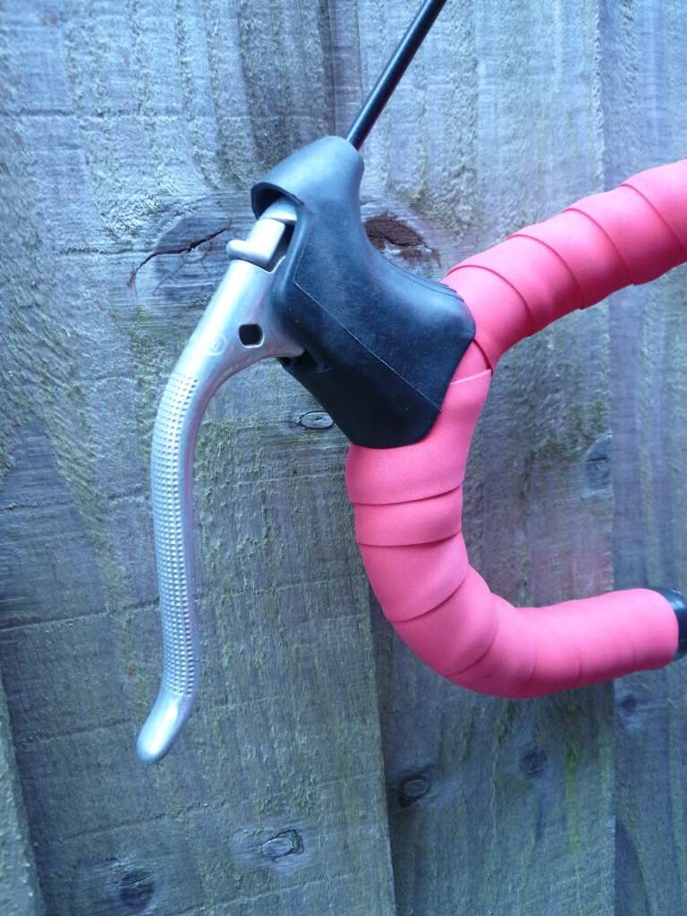

Original weinman brake levers

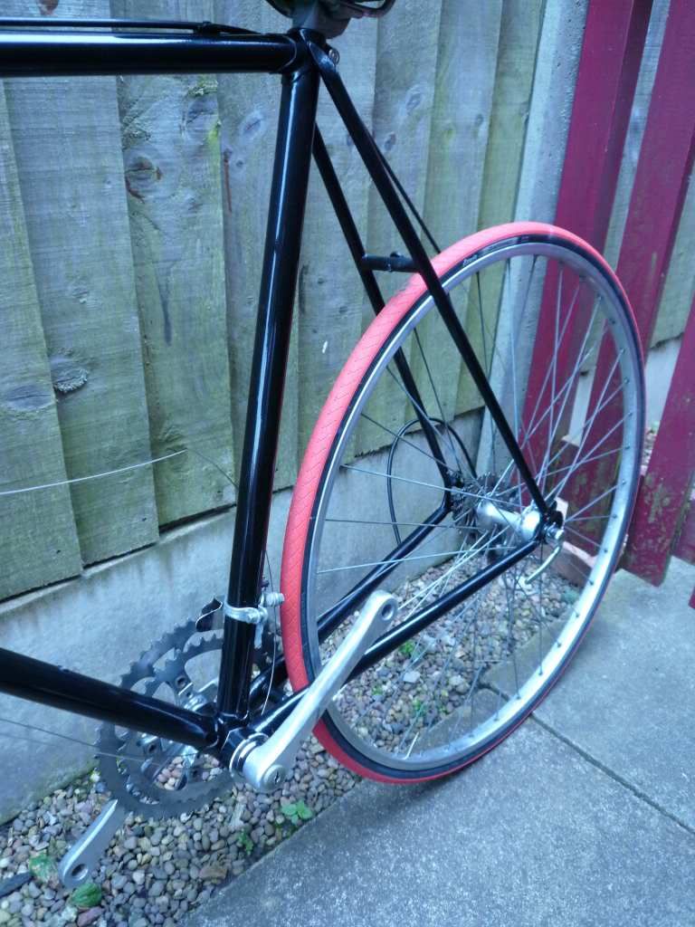

Sakae SA crankset (original?)
Chainrings (look nearly new)
Broken spoke and buckled rear wheel (sob)

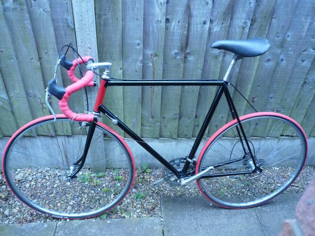

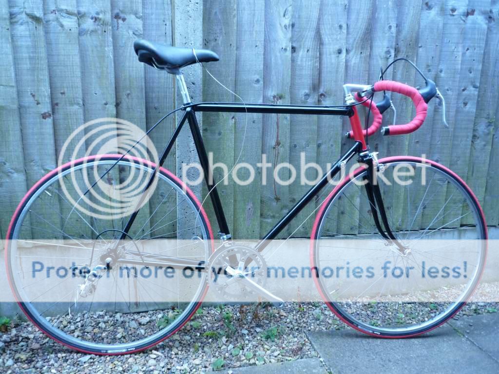

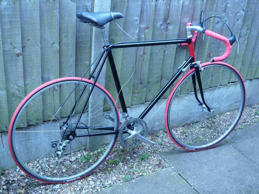

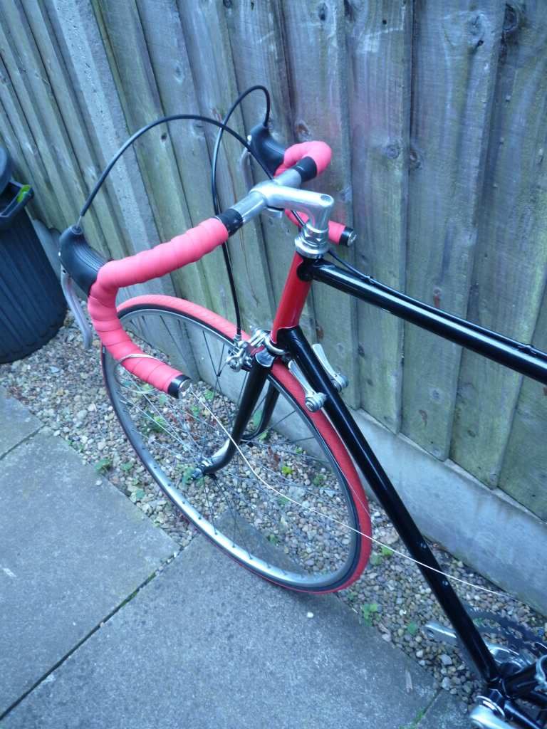

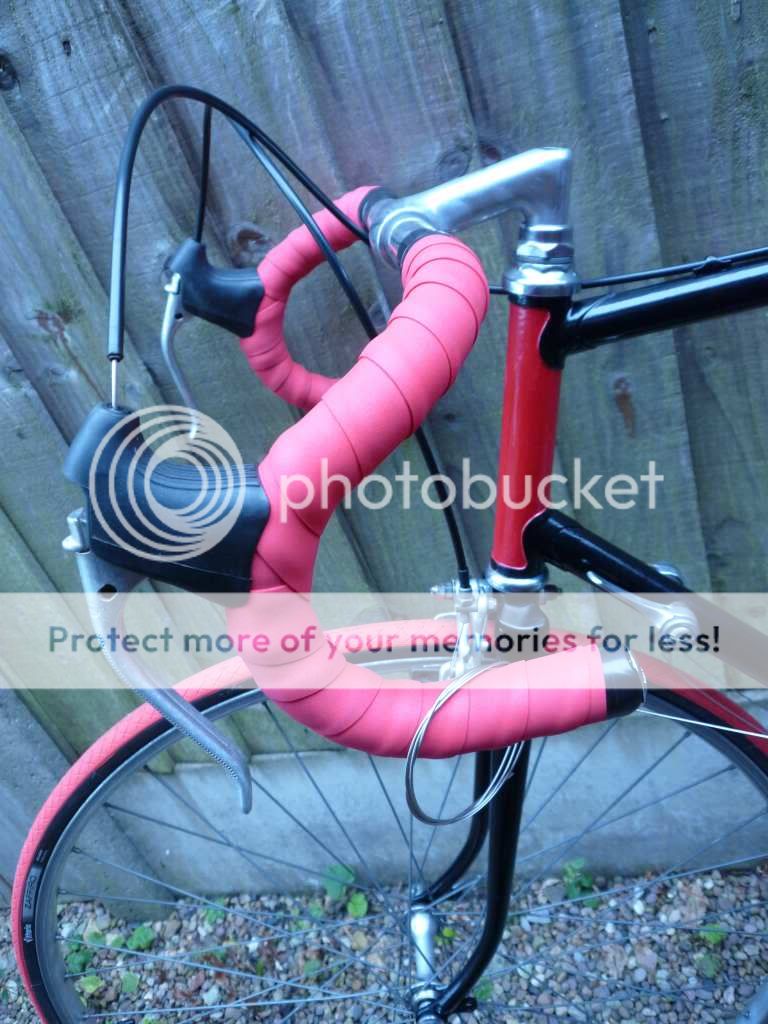

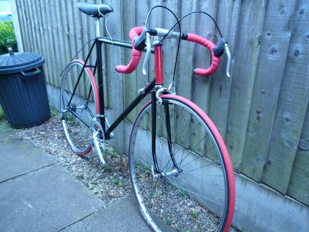

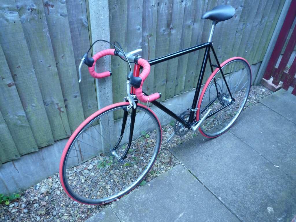

Massive update with pics.

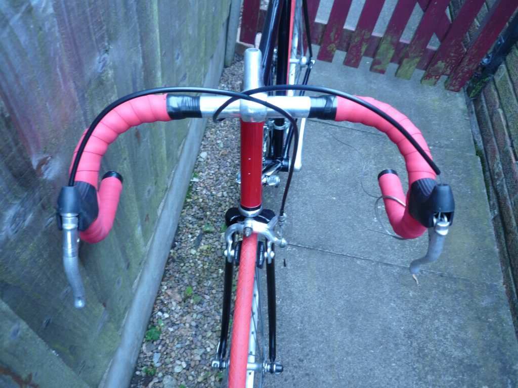

I have had a very busy few weeks so work on the bike has been limited. In the last week i have made huge leaps forward. Frame is now painted and nearly all components are either waiting to be put on or on order. hopefully it will be good to ride at the end of next week.
I will take some pics his afternoon.
Niall
Currently on order/awaiting to arrive
New selle itallia racing saddle (black with red detail)
Decent second hand raleigh head badge (80s vintage)
Red vinyl "Raleigh" and "rapide" stickers
can't wait to get out on it. :D :D
