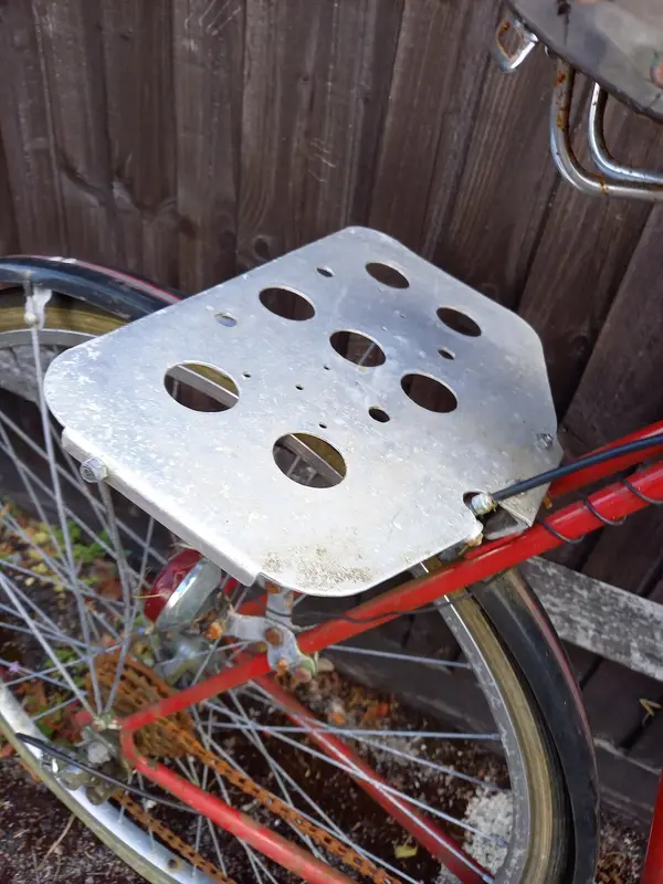

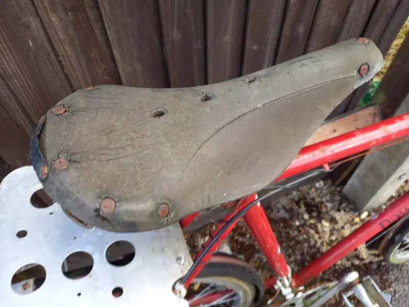

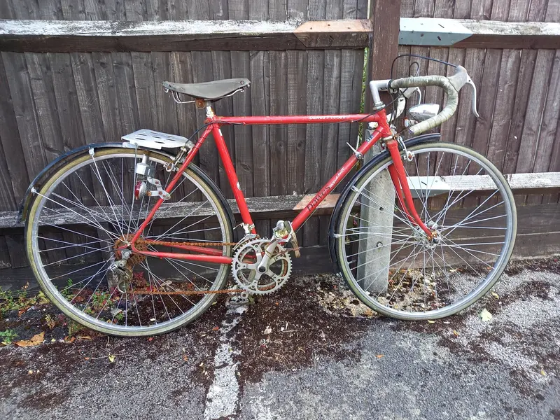

Another shonky Dawes. This time in my size. It's been sat in a garden so should be fun.

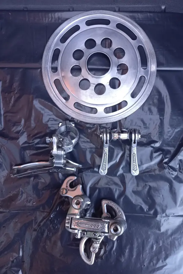

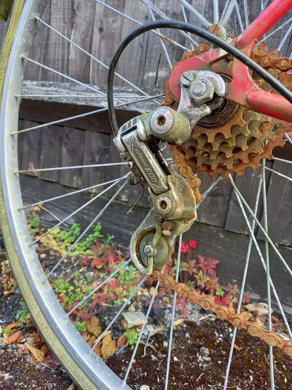

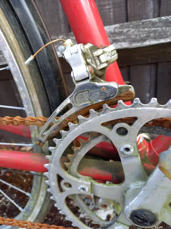

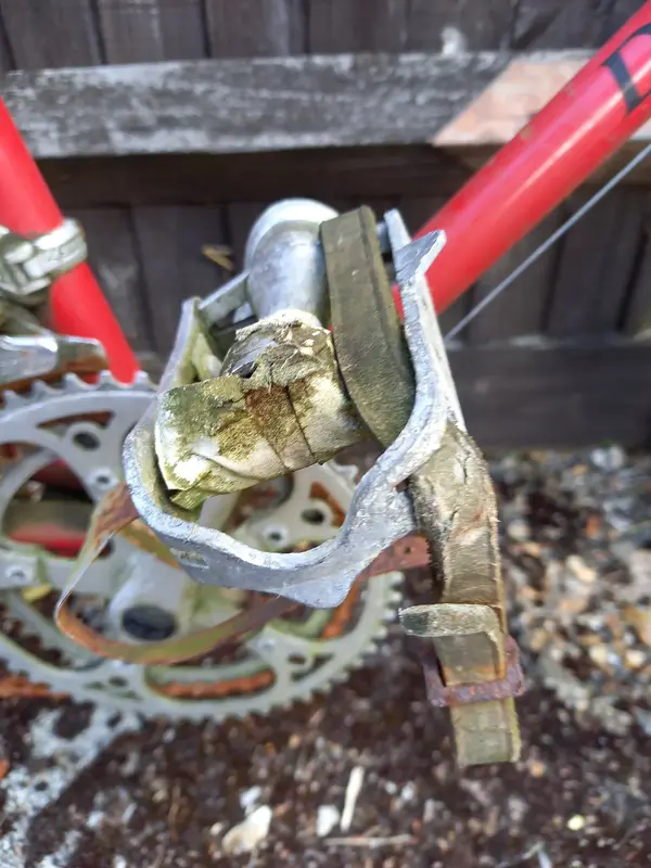

Started the strip down. Stem and seatpost came out without too much effort. Problem areas are the thread is stripped in the drive side chainset so I can't use my crank puller to get it off. Also the pedals are solid. Soaking them with plusgas.
I get the feeling it was once a well maintained bike. The bottom bracket feels good, no play or rumbles so I might leave it alone and save myself some grief.
Ride it up the road with the crank bolts out. They will loosen quickly.

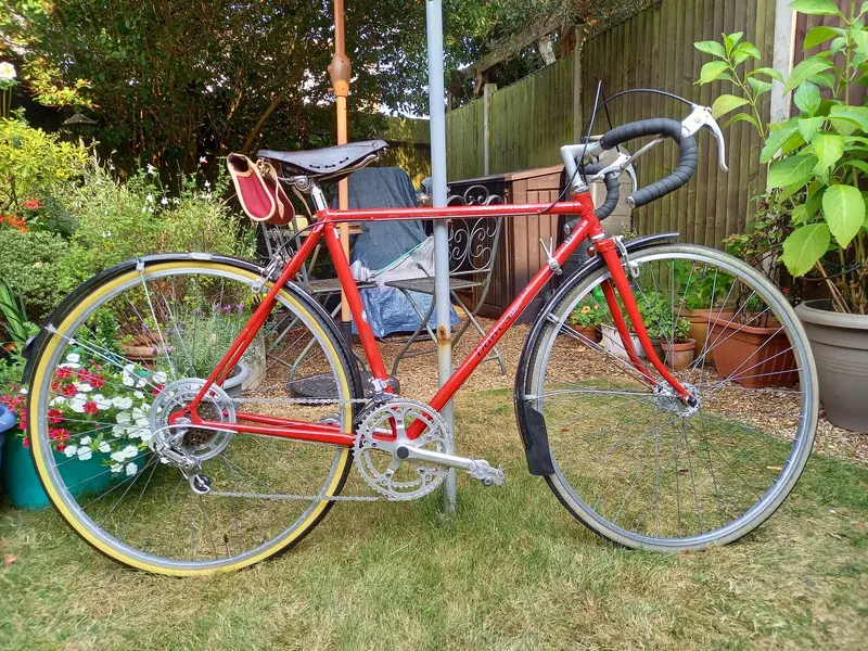

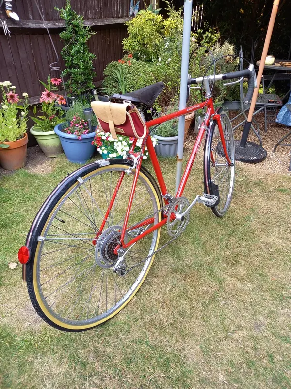

Started to put it back together. Managed to keep the cost down so far using my spares stash. Replaced the rusty steel seatpost with a Kalloy one left from the Galaxy. I solved the missing dust cap on one pedal by replacing it with a SR SP-150 quill pedal I had spare. They don't quite match but it fits in with the budget theme of the bike. 😁
Just need to buy tyres, gear cables and bar tape.

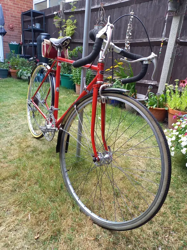

It's sort of finished apart from tweaks. The front Weinmann 730 caliper was badly bent possibly due to falling over and it hitting the frame.
I've used one from my spares but it's a bit too long, the pads do hit the rim but they're at the limit.
Front tyre needs replacing but it holds air. The plan was to spend as little as possible and use my spares stash. All I've bought is gear cables, brake blocks, tyres and bar tape. Plus a lot of cleaning, polishing and regreasing.

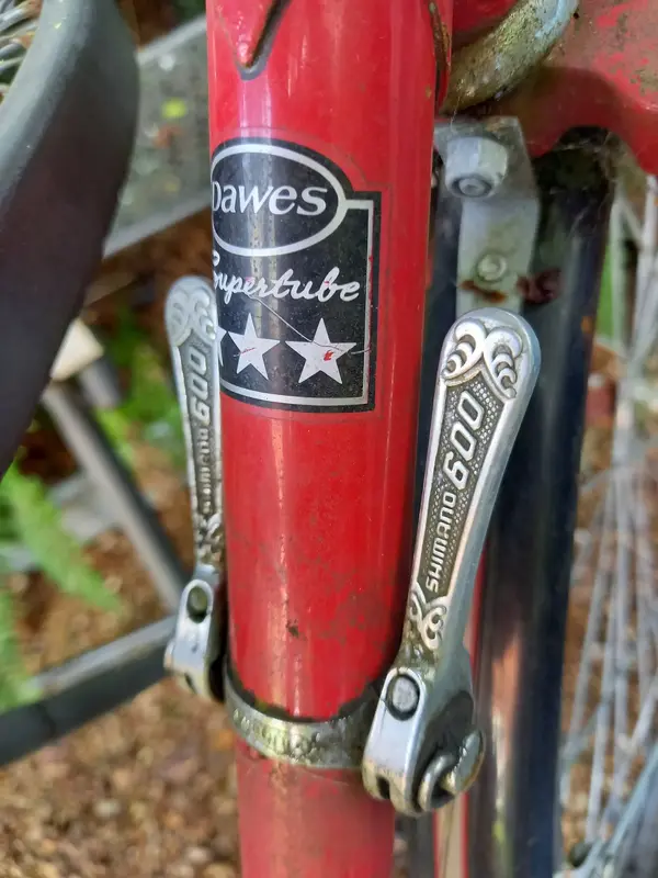

Specs for those who are interested.
Frame: 20" Dawes Supertube (Apparently equal to Reynolds 501) Original paint with a couple of coats of Owatrol for that patina/rough as a Badgers arse look.
Gears: Shimano 600 Arabesque
Chainset and cranks: Superlight
Bottom bracket: Superlight
Pedals: SR SP-150
Block: Shimano
Brakes: Polygon (front) Weinmann 730 (rear)
Wheels: 27 1/4 Weinmann rims with Maillard large flange hubs
Saddle: Brooks B17
Tyres: Duro
Handlebars and stem: GB
Seatpost: Kalloy
