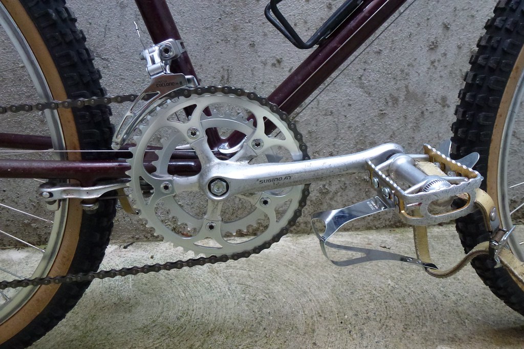

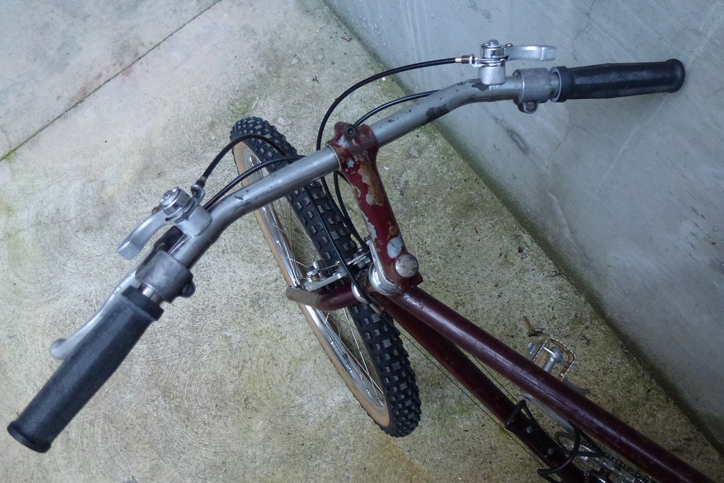

All done now. I’m VERY happy with how this turned out -- and especially pleased I didn’t try to do anything substantial with the paint or (lack of) decals. I think it’s a nice balance between having a bike with a real story to tell -- but that also functions perfectly with a nice mix of it’s original “fabric” and true, period-correct replacements where necessary.
Full gallery (with about 3 dozen new pics) starting here: http://www.flickr.com/photos/halaburt/7134080745/in/set-72157629276135673
Final touches were a swap out to a long-cage ARX that worked with the 32t freewheel and a used set of gold MKS BM-7 pedals.
Thanks for the help/parts from hollister, crconsulting, fatmikeynyc, Bryan D., Steve Potts, and especially Mike Varley at Black Mountain Cycles in Pt. Reyes Station.
I also look forward to sharing the freshened-up bike with its original owner... and I think he’ll get a kick out of it!
Final build specs:
FRAME: Potts Brazed MTB #SP 11-83 052 [a]
FORK: Potts Type-II [a]
HEADSET: Specialized Channel-Lock 1" Silver
STEM: Potts Flat Bar for Stubby [a]
HANDLEBAR: Potts Flat Bar w/Potts Shims [a]
GRIPS/TAPE: Magura Ergo w/CC mod (repro of WTB mod)
BRAKES: WTB "Swiss Cheese" Rollercams, silver [a]
BRAKE PADS: Mafac 5-Bump (with modifications)
BRAKE CABLES/HOUSING: Jagwire (logos removed)
FRONT BRAKE CABLE HANGER: Suntour Head Binder HL-3000, Silver [a]
BRAKE LEVERS: Magura Black Perch / Silver Lever [a]
SHIFTERS: Suntour Power Thumb Shifter [a]
FRONT DERAILLEUR: Suntour Cyclone Mark-II
REAR DERAILLEUR: Suntour ARX Long Cage
DERAILLEUR CABLES/HOUSING: Jagwire (logos removed)
FREEWHEEL/CASSETTE: Suntour Winner Ultra 7sp 12-32 [a]
BOTTOM BRACKET: Press-in w/spacer, circlips [a/b]
CRANKARMS: Sugino AT 175mm; Sugino 15mm Bolts [a]
CHAINRINGS: Sugino 46t / 34t (double); Sugino CR Bolts
CHAIN: Sedis Sedisport
PEDALS: MKS BM-7 Gold Cages
+ WTB Toe Flips
+ Speicalized stainless Toe Clips, Size L
+ Alfredo Binda Extra Toe Straps
HUBS: Phil Wood 100/130mm [a]
+ Campagnolo 1010/A Dropout Adjusters
HUB SKEWERS: Phil Wood Bolt-type [a]
RIMS: Araya 7X 26x1.75
SPOKES/NIPPLES: DT 14ga 4-cross
TIRES: Specialized Hardpack 2.2
TUBES: Modern; Schraeder
SADDLE: Avocet Touring-II
SEATPOST: Campagnolo Super Record 26.8mm
SEATPOST BINDER: Suntour [a]
BOTTLE CAGE(S): Specialized 6.2mm, Black
