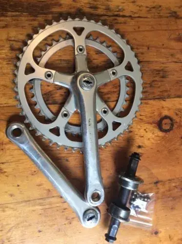

looking at the raleigh sprints i just googled,they have all got different cranks so sugino,sr
anything from that era.
i looked under 'vintage crank sets' if you had a single cottered , you could up grade.
