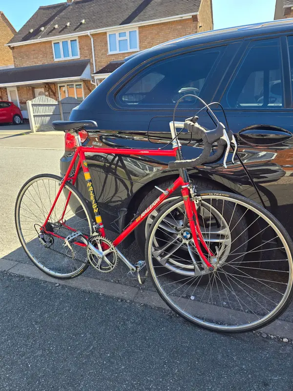

Hi to anyone still on this thread, here's my recent purchase what I believe to be original Reynolds 531 competition replica serial number dating april 82 built at lightweight division
