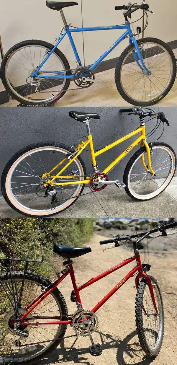

Thanks for clarifying that! The Madrone Trail (so far I have: Red, Yellow, and Sea Blue colors and men and women's frame) was their first bike. That "Chevron" shaped seat tube collar was carried over on the lower hierarchy frames from 87-89.
Thanks again Hamster
The revised 1989 Marin MTB Hierachy looks like this. The Madrone Trail colors and styles so far found.

To answer their question there here, the Madrone Trail was the first bike made by, the then new, joint venture between Buckley and Murray. The bike had a nice geometry and an attractive entry level price of $200 in the US (about $475 US today). Unlike earlier MTB companies, Marin chose to capture adepts with an entry level model first, and went up from there, which might have worked for them at the beginning. There are some online coverage of the 30 anniversary of Marin with pictures of the bike, also shown above. The bike came with a seat tube aluminum badge, which was followed by a sticker in the 1987-'88 bikes, describing bikes were designed by Joe Murray NORBA champ. '84-'85. I believed the Madrone Trail was a 1986 only model, but have found pictures of what I suspect are 1988 and a 1989 both in solid black, the component in the '89, if original, suggest the bike may remained bottom of the model line in those years.
