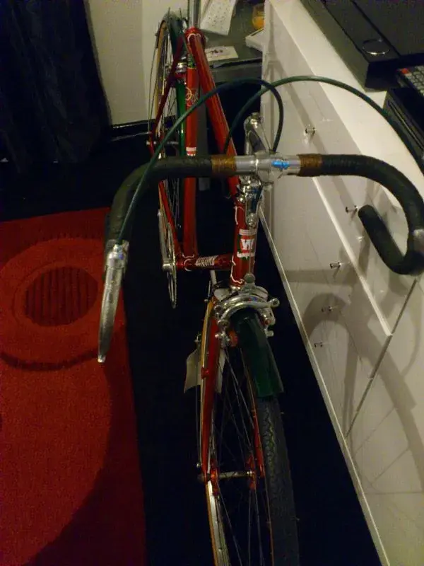

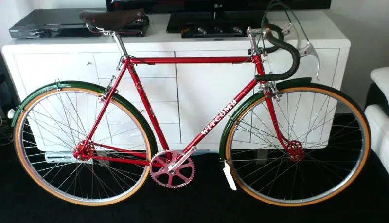

Quick update: Managed to get it together although will need tweaks, stays trimming, pedals fitting etc. Some more poor indoor cameraphone pics, as soon as we get some decent weather will try and snag some decent ones.
The cotton bar tape was gummy and seemed a little pale, so twine wrapped the end and gave it a coat of amber shellac, now matches mudguard a little better and although shiny has a rough, grippy texture.

Gorgeous, I love the slender rake on those beautifully formed fork... knocks spots off the modern rubbish everywhere.
