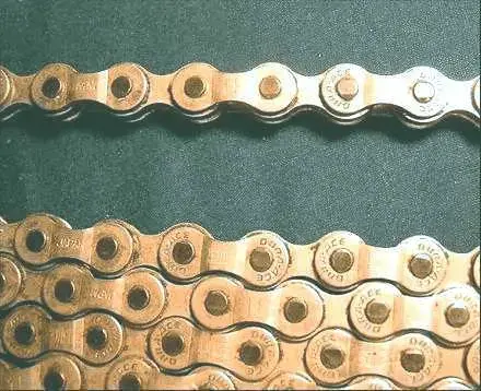

Are you using the thick Uniglide chain?
First step is to carefully undo it, put it back in its packet and place on the highest shelf
Second step is to fit a half decent modern 8 or 9spd chain
'Slow' indexing sorted
The chamfering on the later chains aids the shifting and is really quiet. Uniglide sprockets are fine, the twisted teeth do work quite nicely
Its the first thing I did with my 6spd Uniglide Raleigh
and then theres my 1979 bike with 8spd RSX STI and 1984 6spd Shimano 600 Uniglide freewheel - it runs a 9spd chain flawlessly
*heck a late 1980's early 90's Sachs chain would be better than any of the original 'Uniglide' chains
