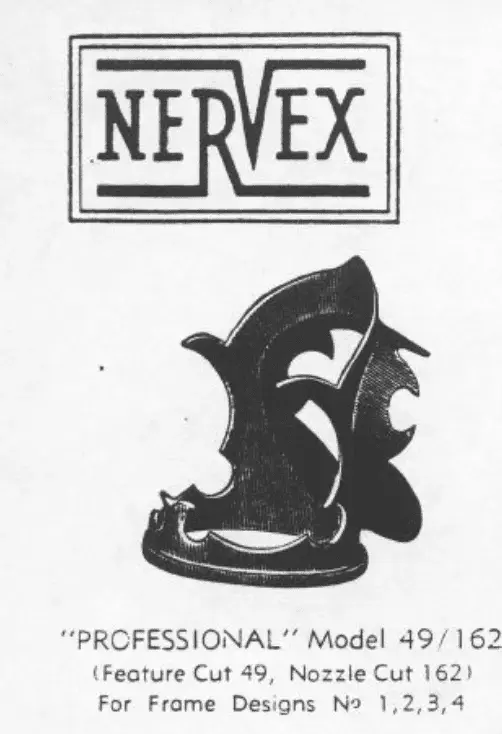

- Nervex Professional lugs (possibly customised to some extent?)

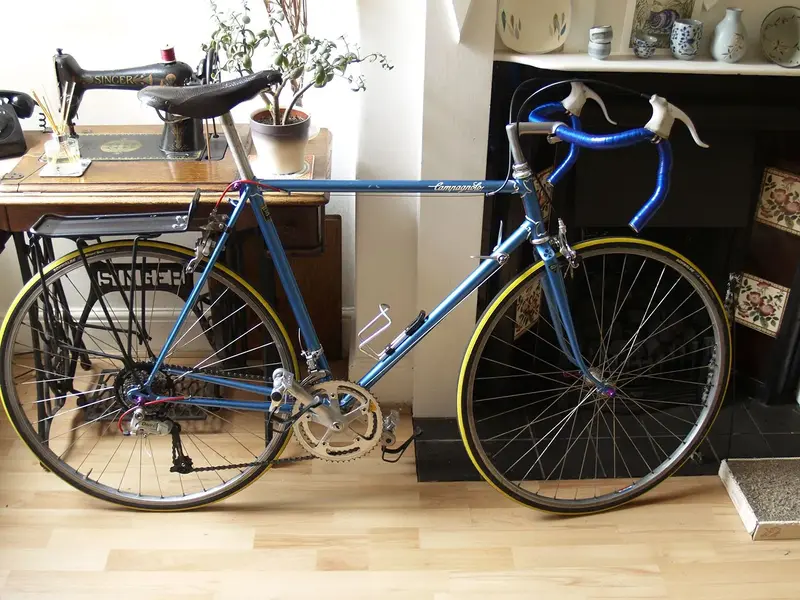

So, starting from the very beginning this is exactly how it looked when I bought it on eBay back in 2013 (complete with awful saddle and bar angles):

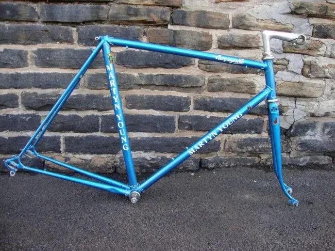

Yes, indeed, very tastefully built up, I think all would agree. More vintage road bikes should have purple anodized parts in my opinion. I asked the seller if he knew more about it, and he sent me a few photos of the frame before he built it up which revealed it previously had the name 'Martyn Young':

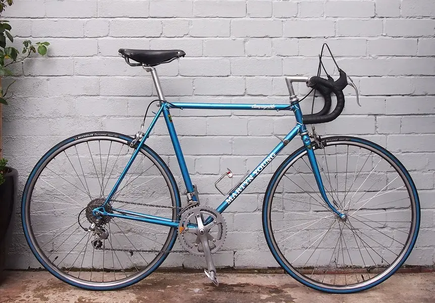

I don't why he took the name off. And no, I have no idea why it has what appears to be a Colnago decal on the fork crown – someone seems to have raided the decal drawer at some point. Anyway, I slowly replaced the bad bits and it eventually end up like this:
As can be seen, I gave it back its rightful name. Certainly a big improvement, although, yes that's not saying much. These days I would do some things differently, but not bad for a first go. And yes, it really is too small for me given that seatpost and stem, but I loved riding it and so it's a keeper. The next part of this story is sadder and will follow shortly...

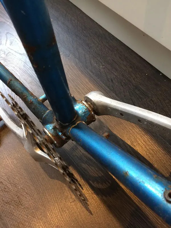

...and now for the sad part. After a few years as my Sunday best bike, after my winter bike died, for some reason I thought it would be a good idea to use this bike as a winter bike (seeing as it can take mudguards). This was a bad mistake. Even after only two seasons, and despite wiping down reasonably well (at least I thought so at the time, I suppose) after each ride, the frame really suffered.
I decided I owed it to this bike to rescue it, and this time do a full period rebuild. In 2021 I took it to a local bike shop (well actually more of just a unit in a massive old works building in Sheffield) who did a respray. They did a decent job although the shot blasting revealed quite a lot of pitting which really they should have smoothed with filler (I presume this is what is done?) or at least asked me about, but never mind. The main tubes are still pretty good, it's most noticeable on the forks.

Nevex pro were mass produced lugs made to look hand cut.
