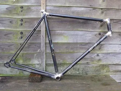

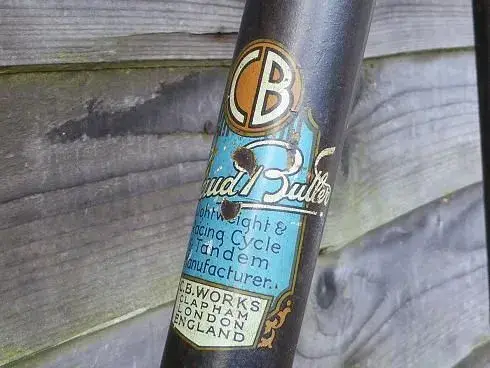

I've been thinking about doing a genuine "Claud" Claud Butler build for a few years now but nothing suitable had come along until earlier this year.
For me genuine Claud Butler meant something produced before he went bust in late 1956 and the Bi-Laminate frame was probably his most iconic.
So when a March '56 dated frame came up for sale on the evilbay I took the plunge on a buy-it-Now, probably for a bit more than I should have.

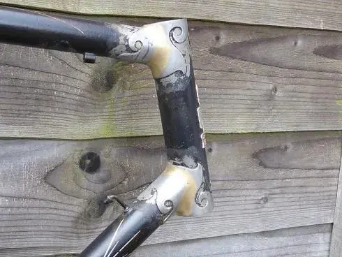

Overall it was in pretty good original condition apart from the lug lining, which someone had badly redone with a gold paint pen.
I'd seen an identical frame at the Ripley bike jumble so knew the original lug lining would probably have been in white and with that in mind got out the Nitromors to strip back the paint around the lugs.
Nitromors isn't what it used to be and so had to use some fine sanding pads on my Dremel to finish the job off, but as you can see the Bi-Laminate lug construction is now clearly visible in all it's glory.
I'm thinking about carefully matching the paint on the lugs and lining them in an ivory white colour to match the rest of the decals and then clear coating the frame to preserve the original paintwork.
Any suggestions on build parts most welcome.

Hello ElectronKid
That looks like a great project and those lugs do look nice exposed. Were the lugs originally black like the frame?
Do you have a fork with it?
That should come up very nicely and certainly something special even if left as is :)
Look forward to seeing this progress.

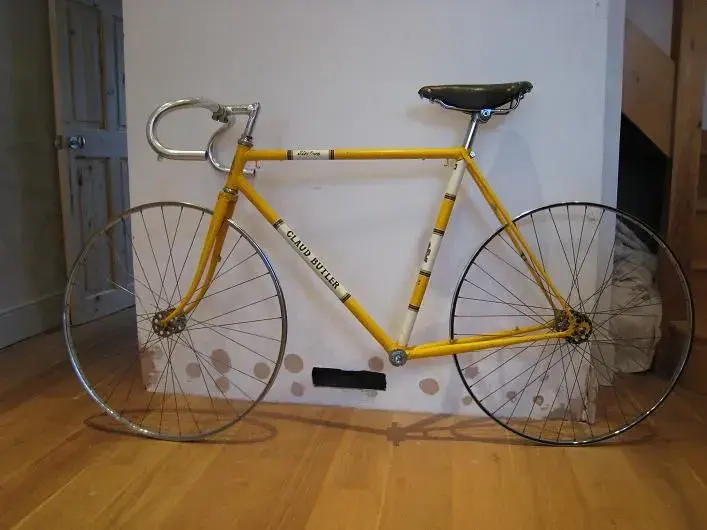

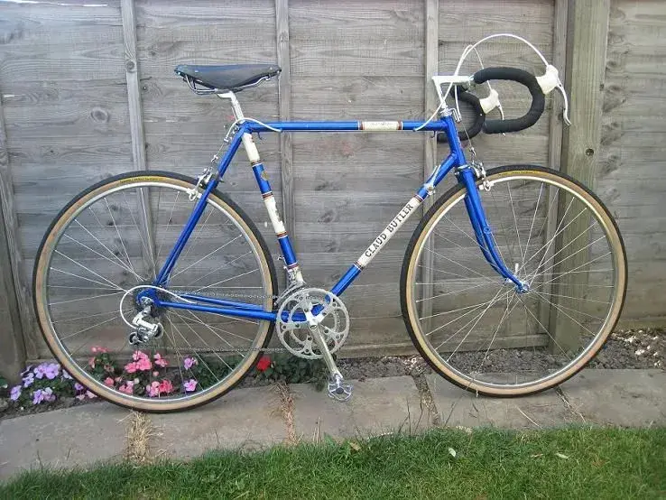

Hi Jamie
Good to hear from a fellow CB Electron owner. They're not the best quality frame out there but I really like the paint schemes on the early 70's models.
I had the Golden Yellow Enamel frame and my brother had the Campagnolo Blue Flam.
We both rode our bikes to school during the 70's, unfortunately the bikes were nicked from our parents garage years later after we had left home.
When I got back into cycling about 10 years ago I saw the same frame I'd had come up for auction on ebay and couldn't resist, even though it was too small for me to ride. Then about a year later a Campag Blue Flam frameset came along and ended up being the perfect build project to give to my brother for his 50th.
This is a bit of a detour from my original post but anyone that has a soft spot for Claud Butler's might appreciate the pics.

Hi Martin, thanks for your recommendations on the build spec.
Great minds obviously think alike, because I've either got, or am thinking about getting most of the stuff on your build list.
At the moment I've got a pair of 27" wheels with Weinmann Alesa rims and Normandy large flange hubs dating from the 80's which will get me on the road but are obviously not period correct.
I'm also going to use my Weinmann centre pull brakes and levers from the 70's, but again would like to get some period correct Mafac's at some point.
The first job on my list will be to paint the bi-laminate lugs satin black to match the rest of the frame, then get a lug lining pen and have a go at re-doing the lug lining in an ivory white colour similar to that on the frame decals.
That certainly sounds like it's all going to come together very nicely with this setup. Will look quite understated with the lugs matching the frame and lined in white.
Look forward to seeing it.
