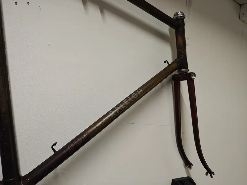

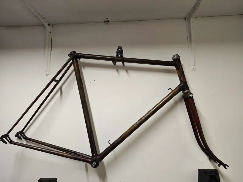

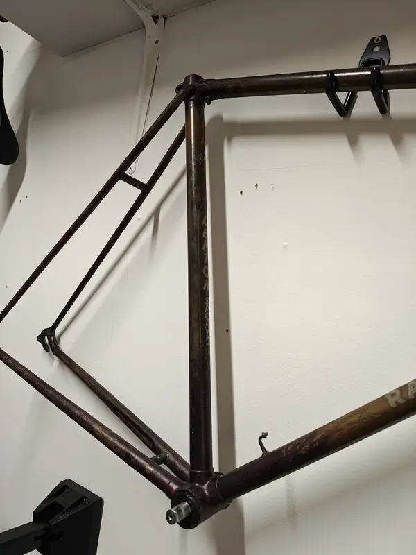

finished prep of the frame, cleaned and protected with matt clear coat - blank canvas...
IMG_20250907_133557444_HDR.webp IMG_20250907_133552359_HDR.webp IMG_20250907_133536672_HDR.webp
... nice frameset once you remove all the heavy bits
