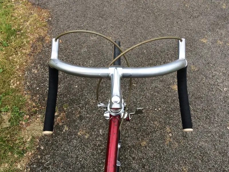

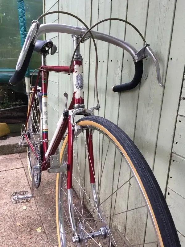

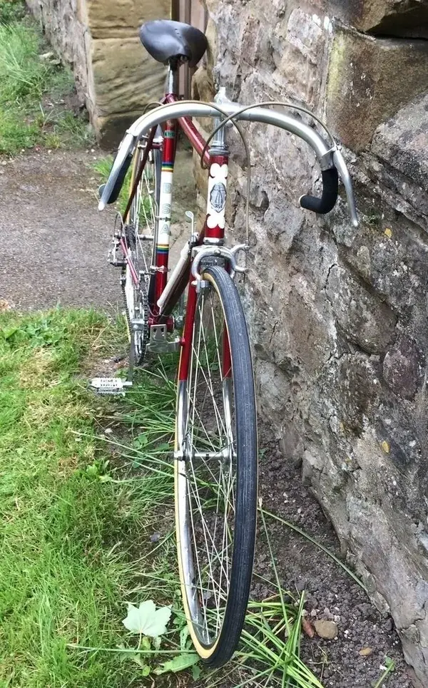

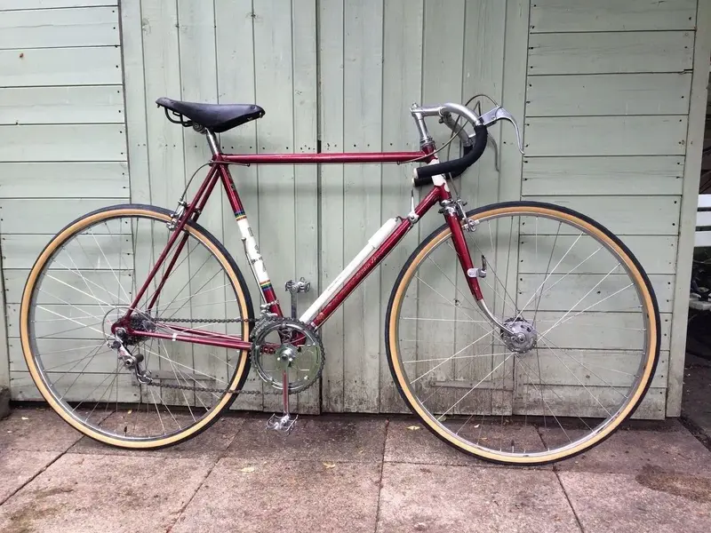

Finally finished - well, 98%!
I need to fit a new chain as the one I have used jumps about a bit, and I need to get an aluminium pump, and light blue ribbon type bar tape to make it ex-factory spec.
I had a test ride today, and the bike rode very well. It is very comfortable, although a tiny bit small for me.
The original owner had binned the Bluemels mudguards, as he thought the bike looked better without them, and I agree, so I have left them off. I will keep them to pass on with the bike should that event come, although I have no plans to part with this one.
I actually found both shifters easier to operate with my left hand. My leg kept getting in the way trying to work the rod shifter with my right hand. But it does work beautifully.
Riders eye view!

Thanks for the compliments, Dennis. Sorry but it is not for sale, it is going to be used for summer trips to town for ice creams with my children. Just got to get them interested in riding vintage too!
I think it might be helpful to add a full specification, so here goes..
Frame & forks: Reynolds 531 plain gauge main triangle.-, BSA lugs.
Handlebars: GB Maitland
Stem: GB Hiduminium spearpoint.
Wheels: Dunlop special lightweight 27 1/4 chrome rims laced with butted spokes to BSA Continental de Lux large flange (four slot) hubs.
Chainset: Chromed steel fluted BSA 5 pin cranks with BSA 49 & 46 tooth chainrings.
Freewheel: BSA 4 speed.
Pedals: BSA quill pedals.
Gears: Cyclo Benelux - downtube shifter, "suicide" rod type front changer, and Benelux sport rear derailleur.
Brakes: GB Sport (Mk1) side pull calipers, with GB hooded levers (pre "superhood")
Saddle: Brooks B15 Champion.
Mudguards: Bluemels lightweight.
I haven't fitted the mudguards for aesthetic reasons, and I still need to find a 16" aluminium pump, (probably Bluemels), and some light blue celluloid ribbon bar tape. Also I have not fitted the Brooks toeclips and straps that were on the bike; they weren't shown in the catalogues - probably a shop fitted accessory.
