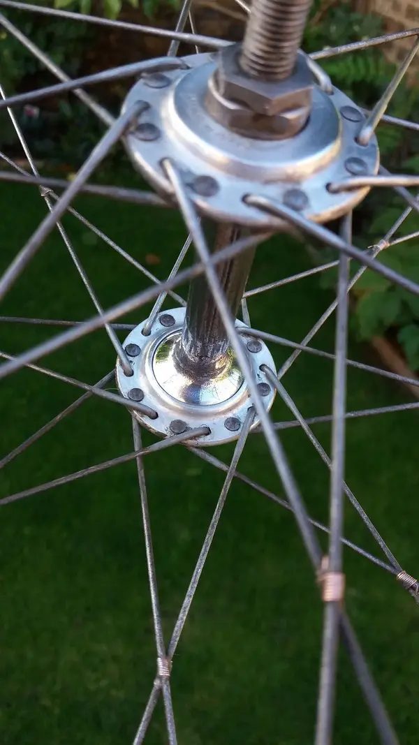

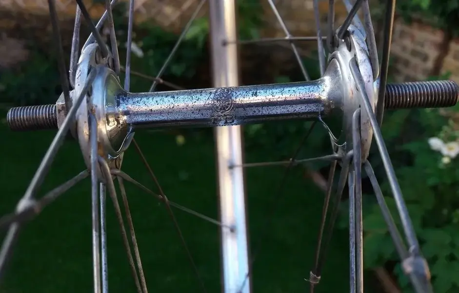

The bike is now stripped to the BB, headset and stuck stem/bars. So I'm slowly starting to clean up the parts, reshaping and proofiding the Brooks (which Hilary Stone confirms to be pre-WWII) and attacking the rust. The front wheel has come up a treat.
Before and after:
