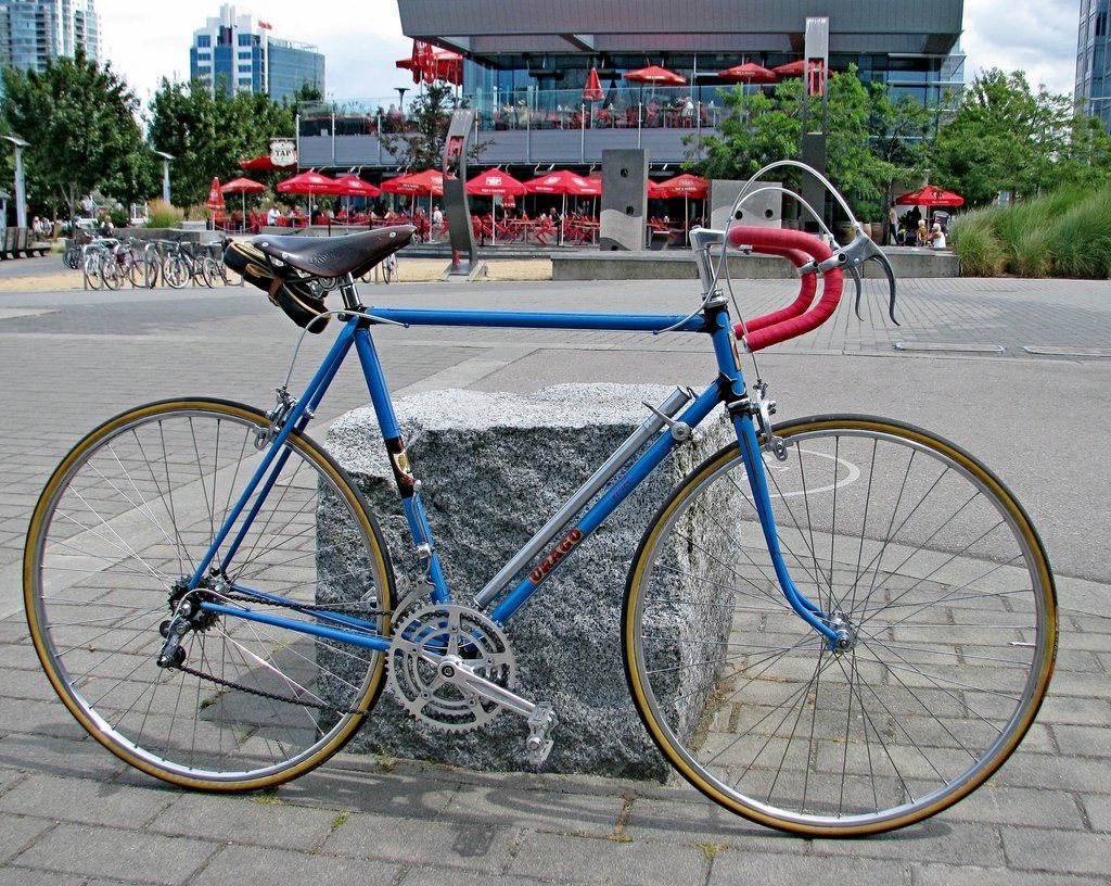

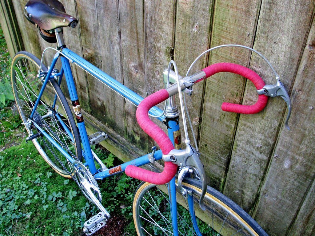

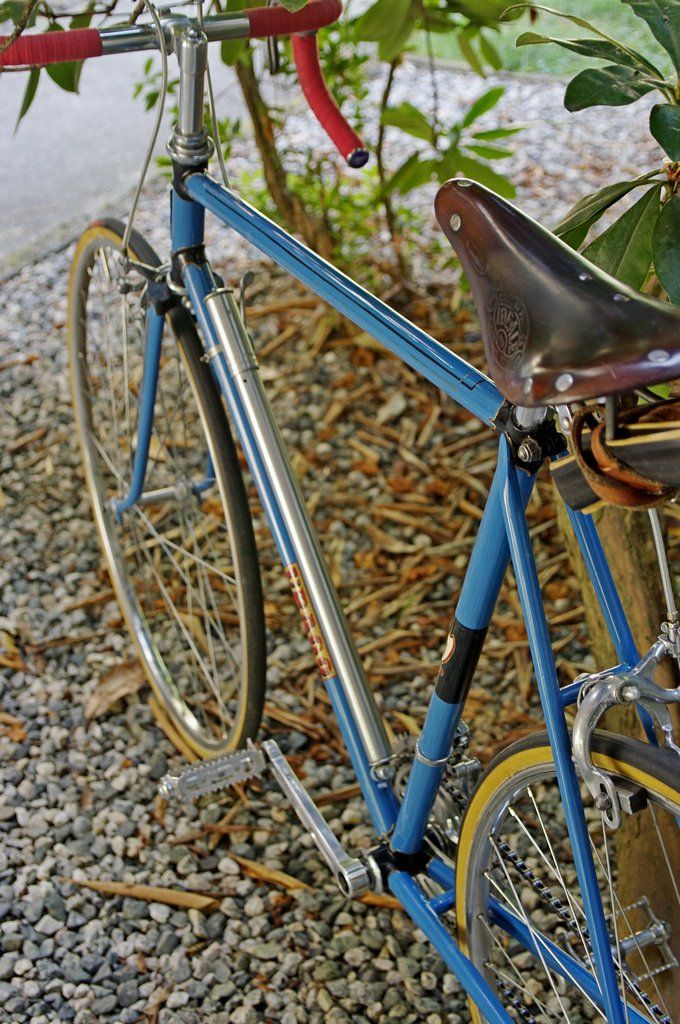

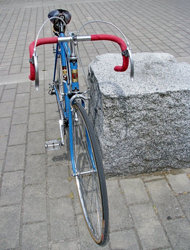

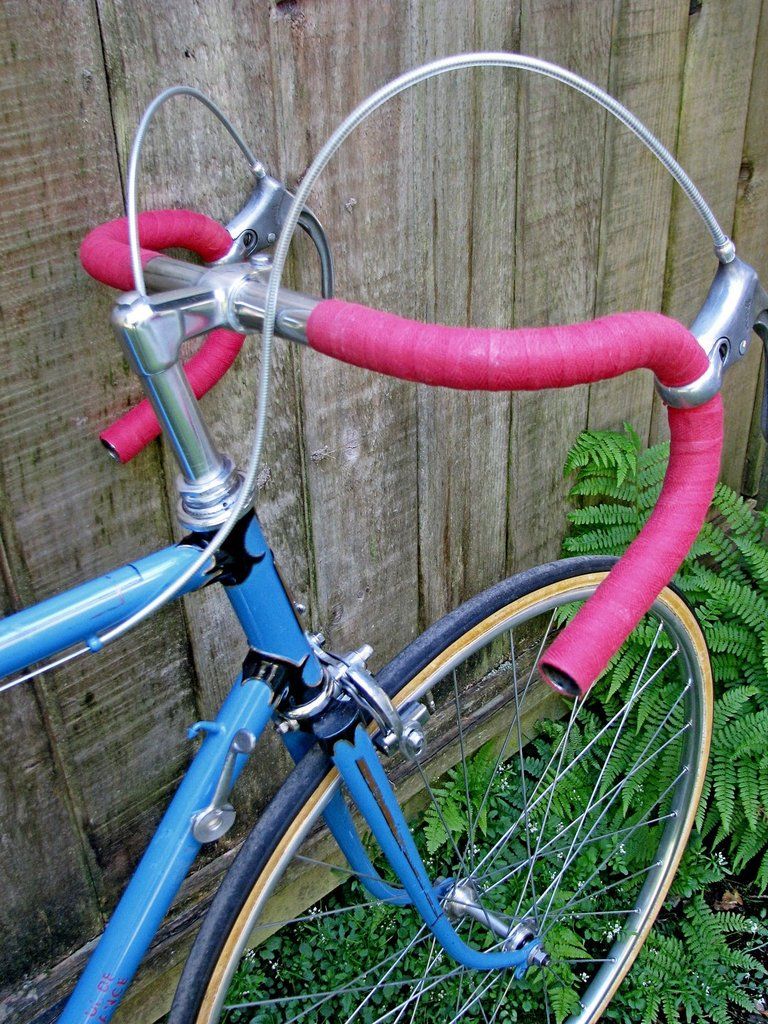

I have been building up this Urago frame/fork for the last few months and with a few final parts on order through ebay France and U.K. I hope to have it roadworthy in another month or so. It has been fun to say the least. I managed to purchase the period hubs, rear Simplex Tour De France derailleur, front Simplex rod shifter ( awaiting clamping band ) and later ( though free ) tubular Mavic rims from the seller of the frame who also happens to have a nice collection of vintage road bikes including a 1948 Rene Herse that is being restored. I have some Challenge Strada 25mm tires on order to replace the basic 21mm on at the moment. The frame originally came from the U.K. a number of years ago to a collector in Edmonton, Alberta and then on to the person I bought it from and now onto me via the local Craigslist. I doubt I will see another Urago out here given how uncommon they are, and beyond that there is little information available. I would think this would have been made for an amateur racer perhaps - mid line possibly. The tubing is most likely Durifort and it has Oscar Egg lugs. I hope it rides and handles decently, guess I will find out soon enough! I plan on replacing the Nervar Star crank set with a more proper Stronglight 49d fairly soon. Because someone forced an English threaded Tange fixed cup into the bottom bracket, thicker than original, I had to locate an axle that would work. Fortunately a Campagnolo N.R. I had on hand worked well enough to use. Some of the other components are: CLB side pulls and levers, Ideale 80 seat, Lyotard 460d pedals, OFV stem. I did find one reference to a repainted Tour De France model, supposedly also from 1952 that was thought to be made from Reynolds 531 tubing, but who knows, given the lack of specific information out there. Here are some images.

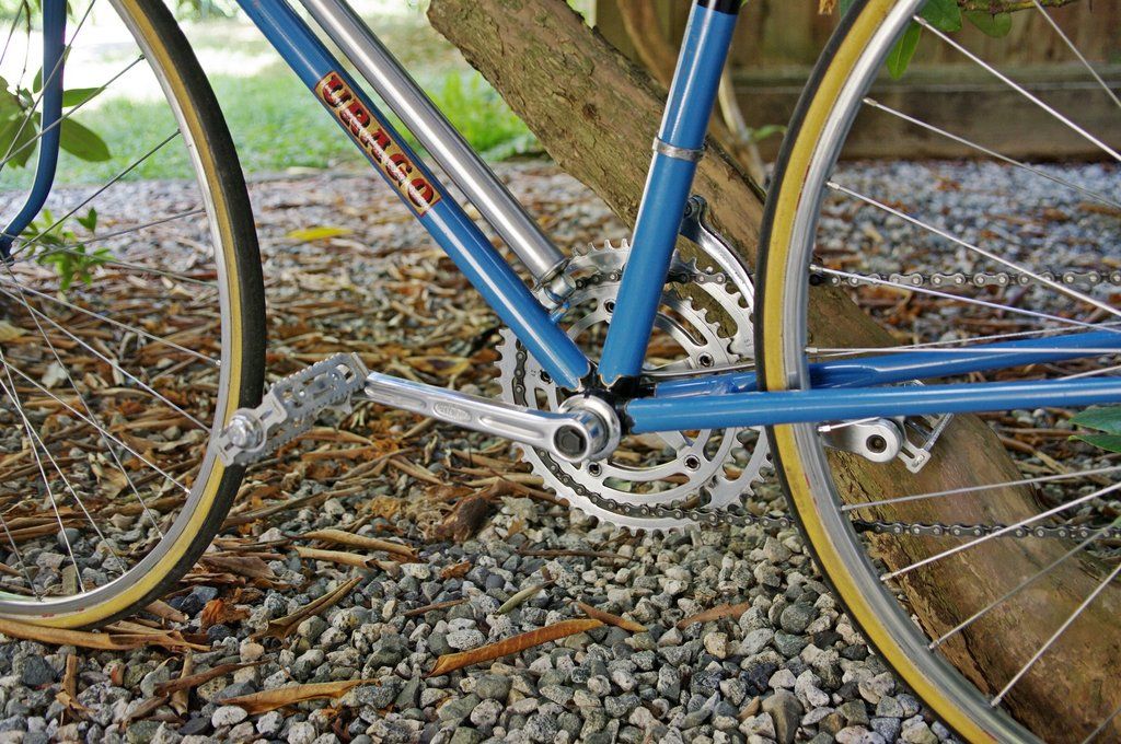

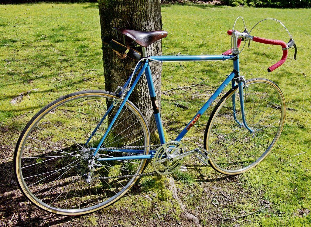

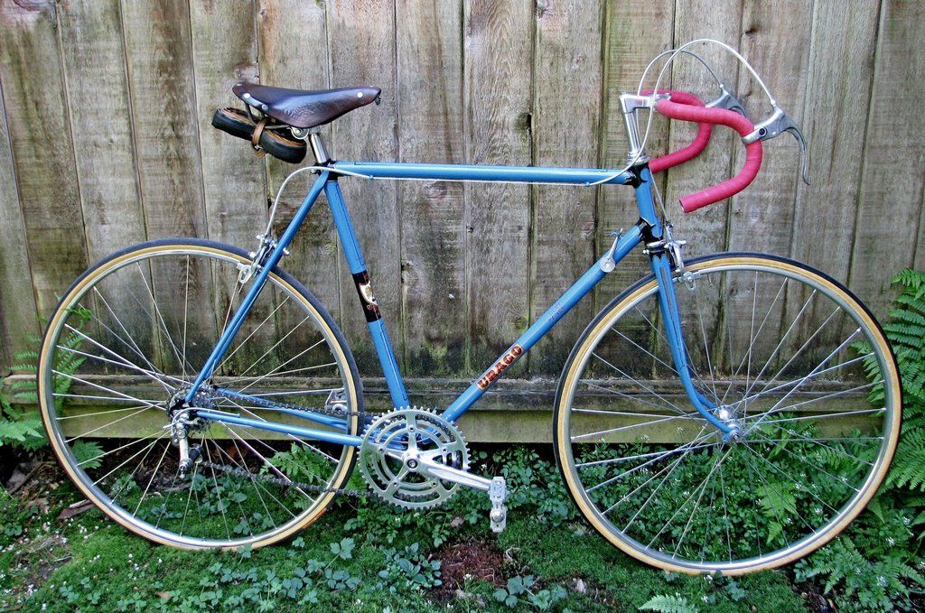

Another update - had it on a couple of rides and it is almost complete, just need to replace the Nervar crank set with a Stronglight 49D and most likely some TA Cyclotourist chain rings. Rides pretty good overall, easy to keep a straight line but a bit light feeling. The geometry favors very low trail, with a fork rake of around 70mm and a head tube angle of 75 degrees ( 73.5 for the seat tube ) it works out to about 18mm of trail, with a wheel flop of 5mm. Tires are Challenge Strada 25mm. Handlebar mounted water bottle would add the finishing touch. I found out that the practice back then was to have the right lever operate the front brake so I might switch them around to reflect the norm back then.

In 1952 the typical chainrings were 47 x 50 or similar. The chainrings in the picture are too much for the T de F gear. Also a bit early for 49d to be used on a racer, really only on tourers then.
Keith
Thank you for mentioning that - I realize that the Stronglight crank set would not have been the norm for this type of bike but at least they are from that era, and I wanted to use some smaller chain rings as I really do not need anything larger than a 46T so for the sake of making the bike a usable rider I had to make some reasonable concessions and decided on some from TA. I was going to go with some cottered steel cranks originally but realized they would be less than useful. One could understand an individual retrofitting some Stronglights due to individual tastes and changing components is done all of the time.
