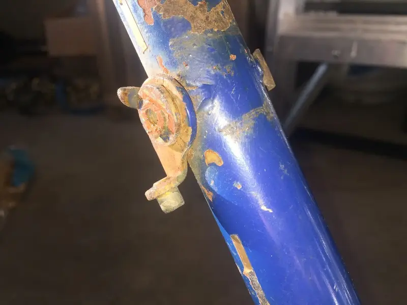

Purchased a 1950 Claud Butler Avant Coureur and according to the resident V-CC CB subject matter expert, the braze on shifter bosses would have been added at a later point. (see photo's)
I beleive they are for Simplex shifters, but am trying to make sure before I start buying off of eBay.

One thing that confounds me is how are the shifters actually secured to the boss? Unlike modern Campagnolo bosses, this has no female thread-in to accept a bolt. Guessing it would be held in place by some sort of clip?
The right side is free and clear of the old shifter that was attached at some point. The left side still has the remnants of a broken off shifter mechanism attached. There are 2 pieces, a round type washer on the outside, and what looks to be some sort of cable guide between the washer and the braze on.

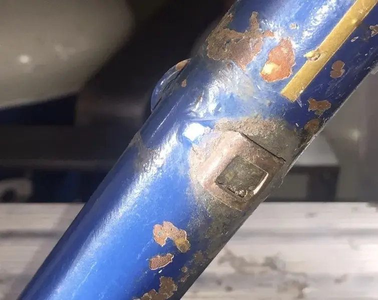

Re: the other / right side braze on
Tried to upload 3 pics in the original post, but only 1 uploaded (the 1 with the broken off shifter piece). This is the right side, free of shifters' pic. the braze on has a square cut out appx 1/4 inch x 1/4 inch, and it stands / protrudes away from the frame appx 1/16 of an inch at best.

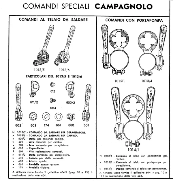

I do have embossed Campagnolo shifters on my 1961 Locomotief which were pretty commun at those days. The shifters itselfs can be moved, the embossed parts however not. There is no lose band...

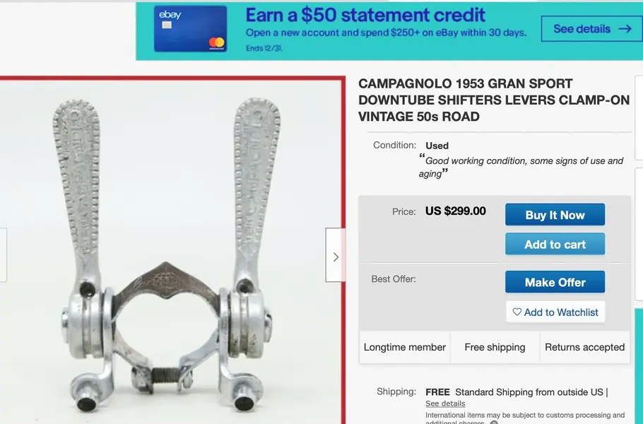

Mystery solved... 1953 Campagnolo GranSport, both braze on and banded right/left shifters. The key clue was the broken off bit... it showed a ferrule that was not threaded like the very similar Simplex and Huret shifters (had to really study the photos to see this subtle difference).
So I found a nice set of banded L/R shifters along with a Valentino / Matchbox front derailleur for $79.00 USD on eBay with free shipping (not the one shown here... this pic is better). Only took a week or so of detective work.
