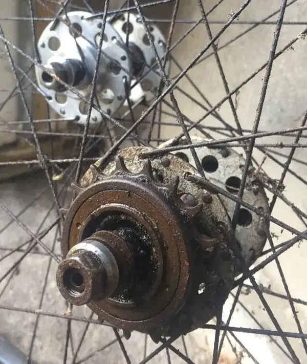

I indeed to keep them! The rims and hubs will polish up nicely so gonna chop the wheels up and polish them, then include them in the sale. The spokes were either falling apart in my hand or held together with cobwebs.
As you can see in the rear of the photo, the hubs came up quite nicely even when the wheels were together so once they're chopped up, stripped and polished they'll be more than useable! And very nice too!
The rims have a lot of corrosion to the braking surface but I'm sure would be fine.

Hubs look like Bayliss Wiley Continentals to my eyes. I still think that this machine should have 27 inch wheels as I am certain that Grubb did not make this frame for 26 inch although Dunlop Special Lightweight rims would likely be correct. I assume that there are no gears since it has a single speed freewheel.
It may have been 27" initially but I was just interested in saving the bike and getting it back on the road so I have just replaced like for like. I didn't know any better if I'm being honest. That is for the new owner to decide. But it'll be perfectly rideable when sold. Even if it is with more budget parts. The original wheels were single speed yes, with the fixed gear cog on the other side. Both of which are certainly too far gone, if they can even be got off the hub. We'll see when I start chopping them up.

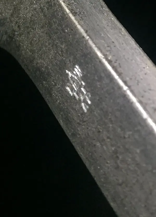

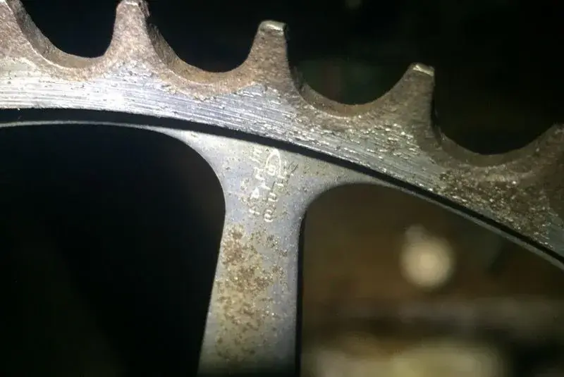

These are the stamps on the crank arms and chainring. Couldn't make them out myself but I'm sure someone in the know would recognise them...

The crank / chain ring have date code AP. This means that Williams manufactured them in 1952. This fits perfectly with the date suggested. As to the freewheel / fixed wheel sprockets, it is better to get them removed BEFORE you cut the spokes out as it is nigh on impossible to remove a freewheel attached to a hub after the spokes / rim are removed. The only way normally is to strip the freewheel and clamp it all in a vice. If you cannot remove them, a local bike shop should be able to. The hubs are worth saving for certain. The rims may be dependant on condition. Normally Dunlop chrome rims from this period are badly rusted due to the plating being very poor (in the early 50's nickel was in short supply and the use of it was banned for a while by the government so plating was sometimes done direct onto mild steel - hopeless really as chrome plate is porous !)

Another tip. If and when you remove the hubs, it is better to use a spoke key to loosen the spoke nipples - say every fourth one - then every third etc before you cut the spokes - in fact, it is better to use the key to unscrew the nipples totally rather than cutting the spokes, but it more time consuming. If this is impossible due to the spokes being rusted into the nipples, cut every fourth spoke on one side, then the same on the other side and so on - this will at least maintain some balance of tension. If you just cut away working round the rim you may find that your rims end up badly distorted and difficult for a wheel builder to lace up later. I have seen rims that look like a figure of 8 when viewed from the side !!
Both the above are based of my own experiences !!
