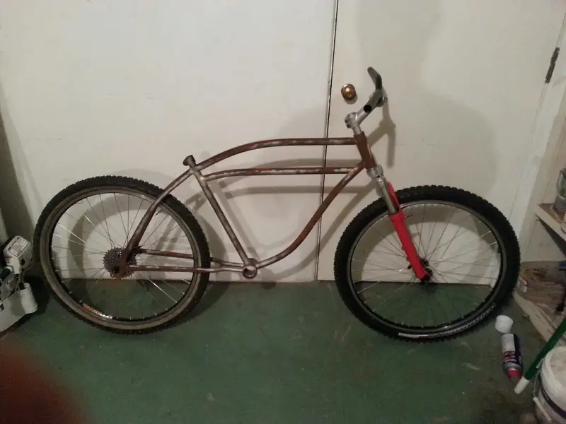

Was fiddling a bit to night. Very quick mock here. Think the bars need more sweep, but still early on.

Re: Recent Barn Find(Thrice is a Charm)
I've read that a 1-1/8" BMX headset will work on Schwinn head tubes. I have no idea what size a Cleveland is, though...
All searches for a headset are coming back with nothing in 1 1/8" Guess I'll have a standard 1 1/8" turned to fit, since I'm not after a rigid or 1" fork.
