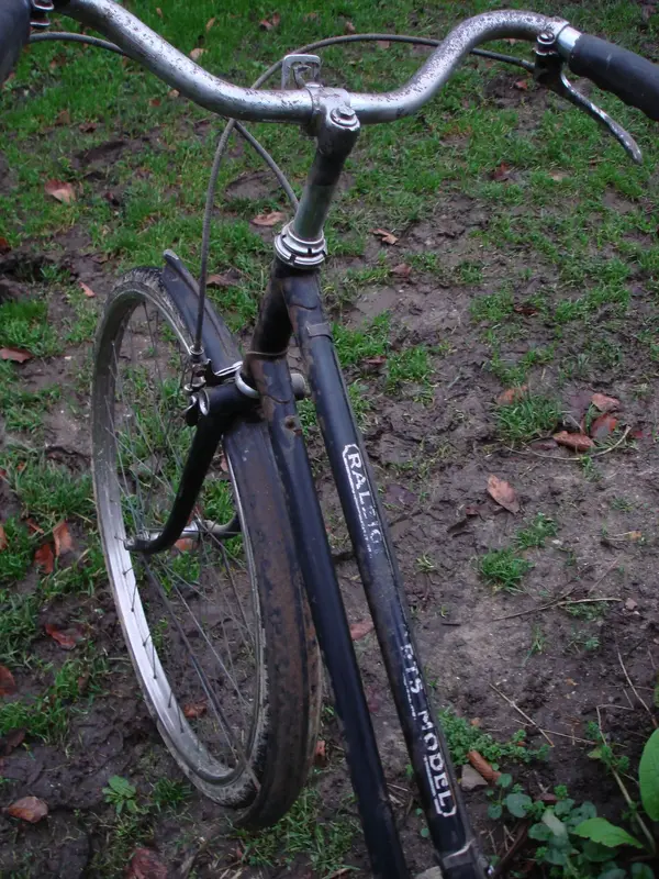

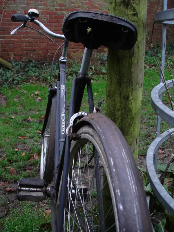

I have a 1940 Ladies Model 36 with those stainless spokes. Still had chrome bars etc but the wingnuts for the wheels had gone in the 1940 catalogue so you needed a spanner for the flip flop hub.
Hi dorset boy,
Thanks for your reply.
WOW a rare Ladies version and Wartime Built too. Would love to see pictures of it.
Raleigh eventually went to Wartime Finished Bikes with complete chrome deletion in black for all parts that were normally chromed. If memory serves me right Raleigh ceased bicycle production in 1942 for complete Wartime Arms Production
Here she is.Found in a barn covered in ivy up to an inch thick,tyres and rims were shot so i laced some stainless raleigh rims on.Put new tubes and tyres on her,new chain and some oil and grease, she still had the original saddle on but the Shockstop grips had perished.Rides really nice. DSC00408.webp
