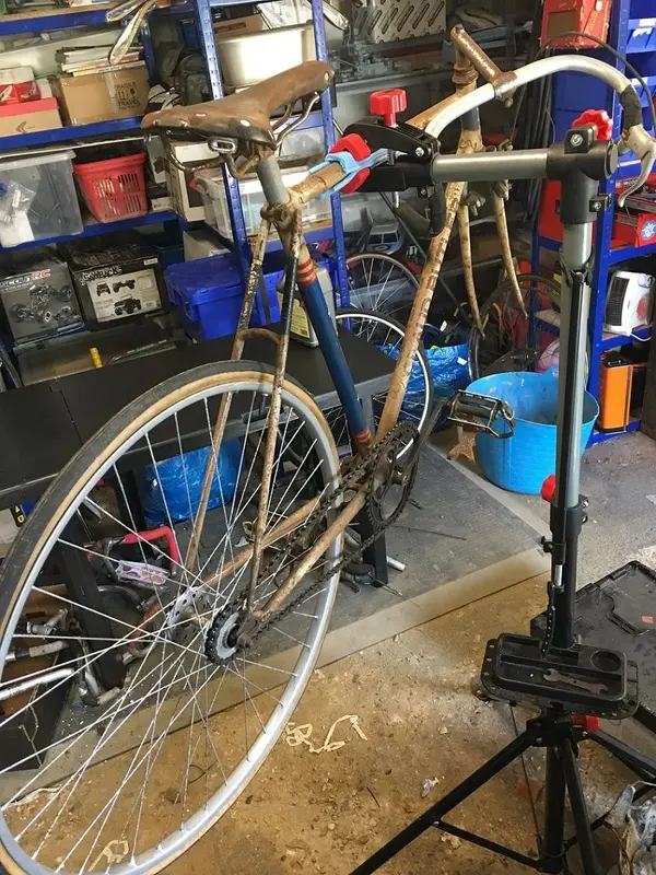

Glorious day, family all out and I’ve got a few hours to kill before the England/Sweden kick-off. Lets have a crack at stripping down the Yank……
First off, I need to dig out Dad’s spanners! When 13mm or ½” are both too small and 14mm & 9/16th are just a bit too loose, bring out the 1/4W (and other weired combinations that I’m pretty sure my father did tell me about, but I’d long dismissed….)
Re: American help required - stars & stripes Claud Butler

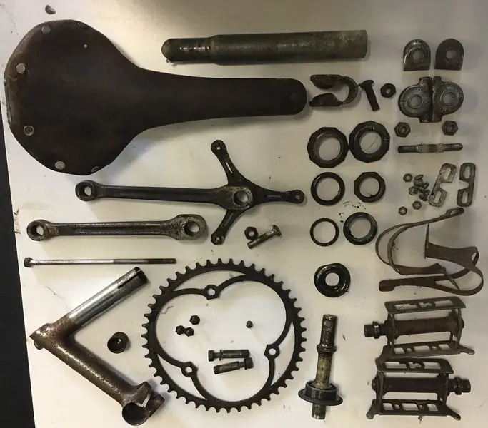

Superb football match, patriotic duty complete, now on to what I really want to get on with.
I had already given all the bits and bats a good squirt with WD40 every few days for the past few weeks, so everything came off without too much of a fight. After close inspection one or two things probably won’t make it back on…. The bars, plain and simple, no stamps but bent and twisted all in the wrong directions, front brake was never going back on anyway, but its pretty bent up & knackered, rims also look shot too. :(
Everything else is looking good. 8)

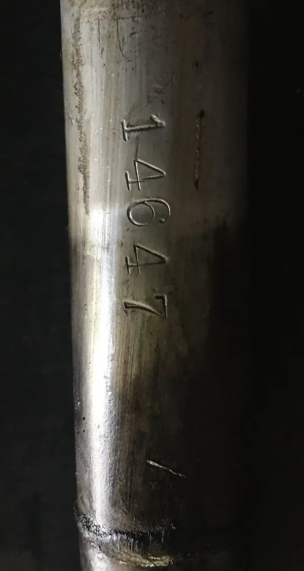

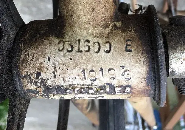

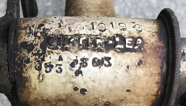

Something I did notice today whilst cleaning was the fork number; 14647 this doesn’t match with either the 931600 E which I’m assuming is the frame number and fabricators initial as I’m convinced this is a 1949 Path, (common thinking on pre 50’s CB’s is that the first number corolates with the last number of the year with the subsequent number being the month, so ‘49 & March, production no 1600) or the other erroneous numbers on the Chatter Lea bottom Bracket shell 10190 & 053 563
I’m not going to get hung up on what these numbers mean, but it does look like these forks might not be originally paired with this frame.

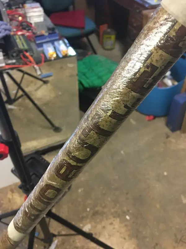

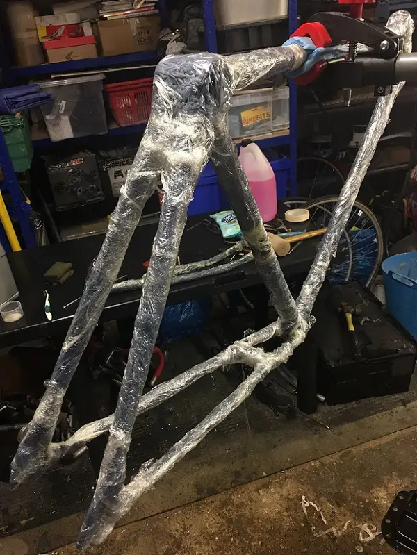

Next step, bit of a gentle wash with some help from Muck-off in some of the heavily soiled places. I must say I am a bit disappointed in how much paint damage was under the dirty areas, I had hoped the muck had persevered some of the paint, unfortunately it looks like it just grabbed onto the areas that had already chipped & rusted badly.
Hey ho…the game is not over yet, first I needed to mask up the graphics, these will be worked around locally later. Then it’s a wrap with paper towel soaked in Evapo-rust then sealed in place with cling film. not exactly sure how long for, I'll just have to sneak a peek every now & then...

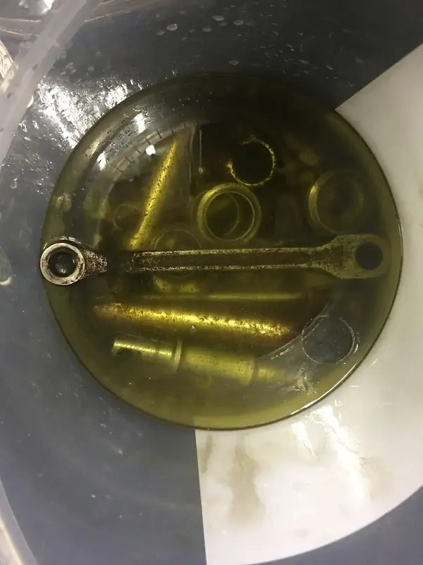

The bits and bats went into last years Halloween :twisted: sweetie bucket, then covered in Evapo-rust. Fingers crossed its all good latter today…maybe tomorrow :?:
