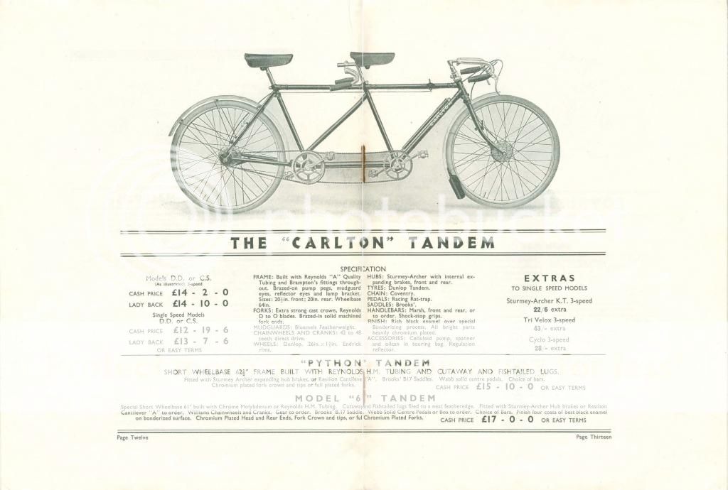

Could it be a Carlton, more digging to be done.

Carlon did make a few tandems, later than this I think.
I'll do m best to get a picture.
Mike
The earliest Carlton Catalogue I can find is 1937. This shows a Tandem and the Trivelox gear is listed as an extra at 42/- This would have been the type A gear by 1937 though.
Anyone have access to any earlier Carlton catalogues?

I am now thinking that Carlton is probably not correct either as in the 37 catalogue it says about fishtail and filed lugs which mine does not have.
