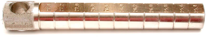

S'pose you could use one of these?
Seatpost sizing rod, LBS would have one.
Seat post sizes
