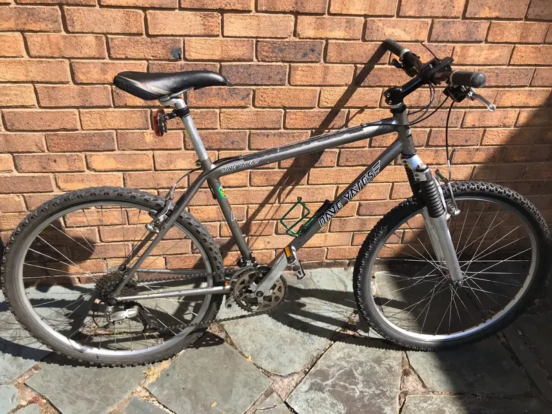

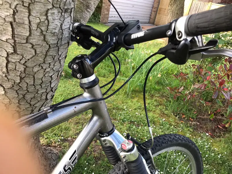

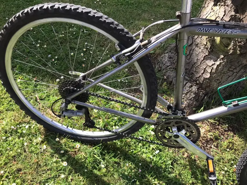

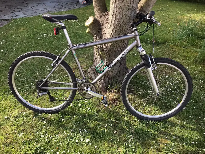

I built this up for my mate probably ten years ago as a very nice runaround - he's not a mountain biker as such, so it's been used as a "riding around" bike and not had a hard life at all. It had new brakes and drivetrain at the time (only Deore) so was meant to be functional rather than fancy
Handbuilt Dave Yates frame, built in Reynolds 853 with fillet brazed joints & Ritchey cowled dropouts. Plenty of scratches and a bit of surface rust here and there but in generally good condition for its age. Would benefit from a respray (see below)
Good bits:

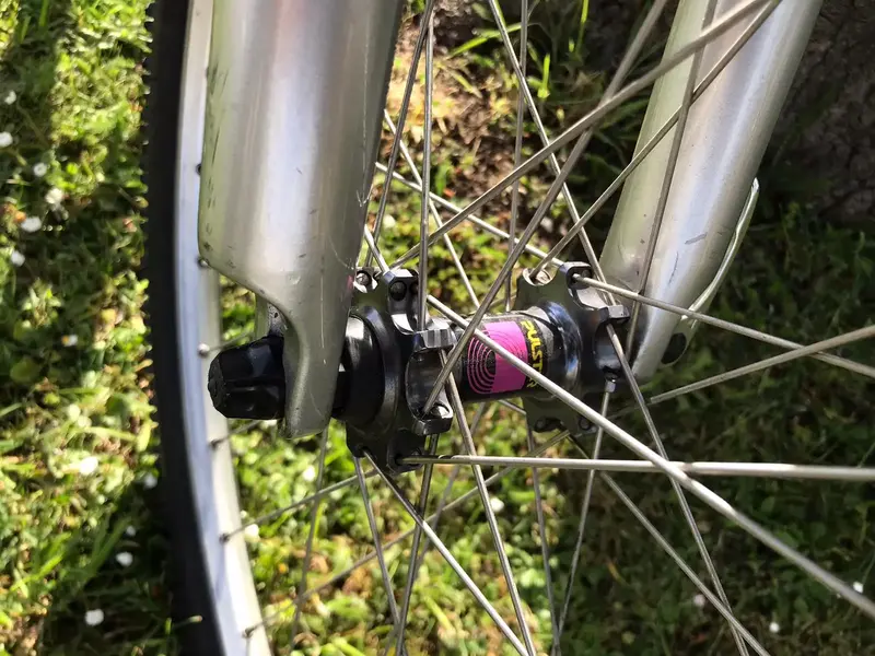

• Fantastic Pulstar hubs on Mavic rims
• Trvativ Stylo triple crankset
• Rockshox forks – not sure of model but working fine
• Shimano Deore v-brakes, shifters and mechs (9 speed)
• Titec bars
• Unbranded stem and seatpost
• Bontrager saddle
Bad bits:
• Sadly the seatpost is stuck in the frame – not tried too hard to remove it. As it’s in need of a respray anyway, I had intended to strip it for that and would have sorted the post anyway.
• As above, could do with a respray.
The bike is in Wrexham. Ideally collection only (social distancing being met!) as packing the bike, with the seatpost stuck in, might be problematic.
Bargain access to a custom built frame by one of the best builders in the UK, with other highlight being the wheels. Gears, brakes and forks are functional, just not of the standard this frame really deserves – it should be dressed in XTR really!
Let me know of any interest and I'll put you in touch with my mate directly via mobile/txt
£300 given the seatpost issue
