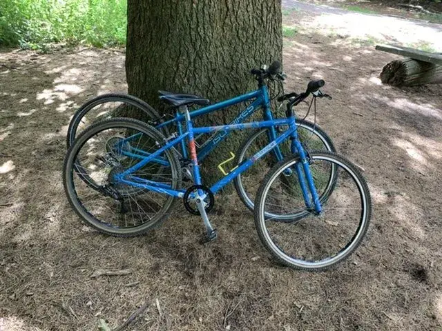

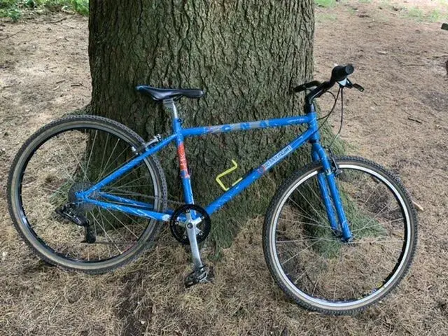

Here’s my effort and in contrast to a modern Isla bike, slightly smaller
