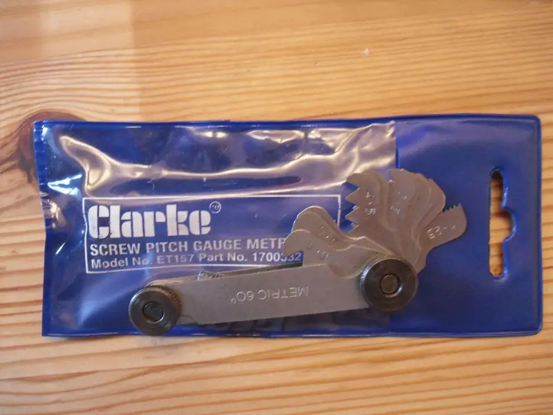

If you own a vernier caliper gauge and a set of metric and imperial thread pitch gauges, it's fairly easy to find out the thread of the existing spindle. Once you know that, you can obtain a longer spindle with the correct thread.
These are the thread pitch gauges I bought for measuring bike parts:
Metric will be in Millimetres per Tooth (spacing from one tooth to the next). Clarke part number 1700332.
Imperial will be in Teeth Per Inch (TPI). Clarke part number 1700333.
