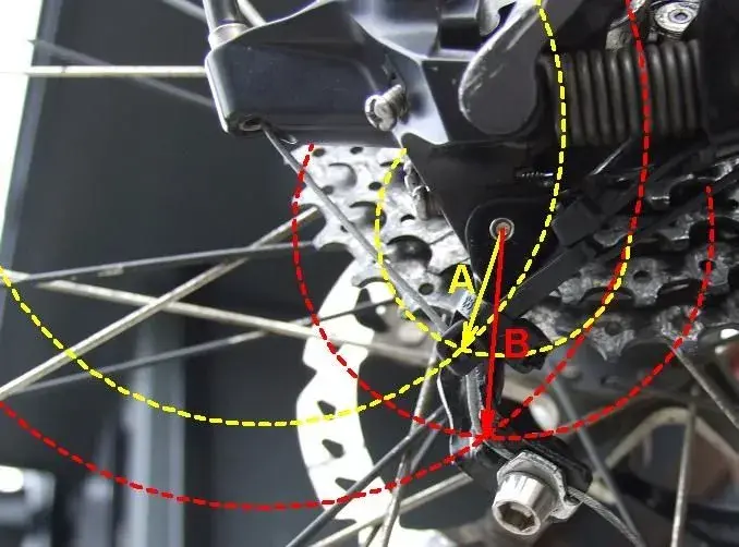

I believe you can do it with a Sram mech Shimano shifter and a spacer.

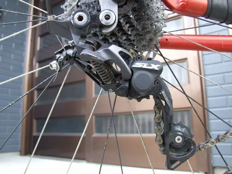

I like that with the brass spacer, found these pics using zip-ties, it scares me a little to do that knowing how easily they can fail when they're that thin. I have just been on CRC and ordered a 10 speed mech, cassette, chain and shifter so I can finish it off and know it will work as I dont have access to sort out a nice little spacer like that right now.

sic_nick":2ekdr149 said:
Sram mech and shimano shifter? thought the Sram ratio wouldn't work with a Shimano shifter!
They don't, hence the spacer, but looks like I got it back to front.
I was looking at this: http://sheldonbrown.com/cribsheet-spacing.html#overhang
The difference between the sprocket centres on a 9 speed cassette is 4.34mm and 3.95mm on a 10 speed, so the cable needs to be pulled 9.4% less per click.
