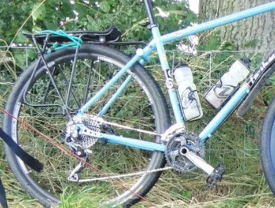

Without stating the obvious but how did you think you fitted a chain?
How do you extend one if you can't add links and trust it? You use two quick links and a bit of spare chain between them so you don't have to refit any pins that might fail. I repaired a damaged chain this way last year on tour.
Hope that helps. Unless you were being facetious?
Spot the quick links!
