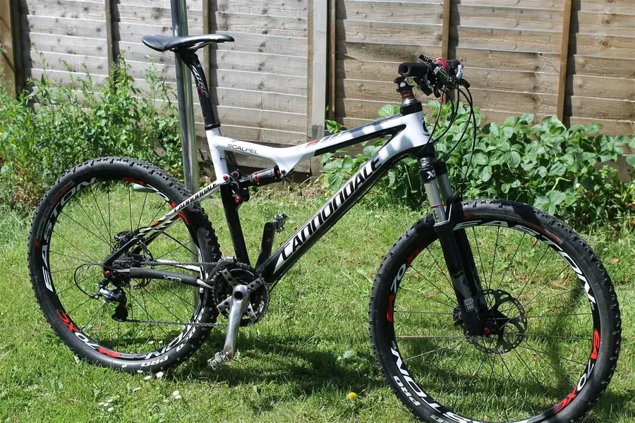

Thanks everyone for these interesting thoughts - I'm glad to hear it's not quite clear cut but it sounds like I'm going to need to try 1x properly for myself at some point to see how much I like it. My original post was a couple of months back and to finish the build off (photo below) in the meantime I've provisionally gone with the triple XTR drivetrain I had left over, but I may still take the plunge if a good 1x10/11 setup comes along...

I like how the cannondale looks now 🙂
