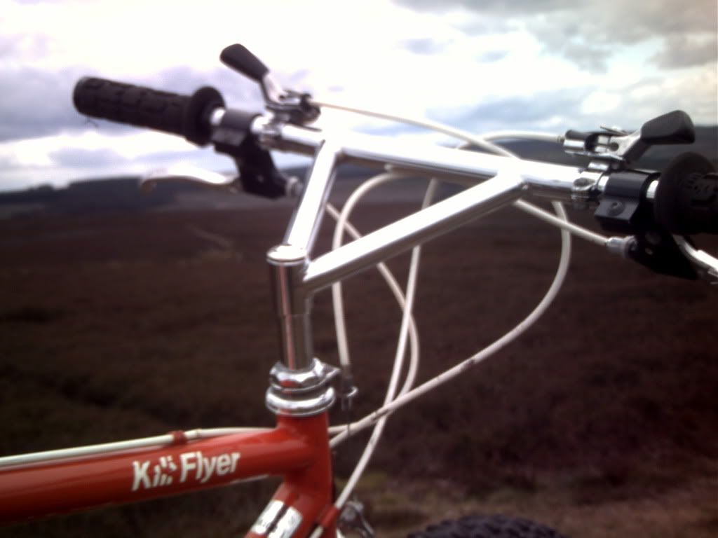

I had a 21.1mm mounted in a 22.2 fork for some time, with a coke can shim. This was not used for any extreme cross-country action though, and I have now swapped it for a correct stem. With the correct size shim, I can't see any major harm as long as you don't plan on riding half-pipes etc.... :D
The owner of this bike has pop can shimmed the quill. The bike has done hundreds of miles on some of England's toughest moorland. No trouble at all.
22.2-21.1mm

that looks like a similar bar i'm wanting to try also.
will see what it looks like. not sure yet.
