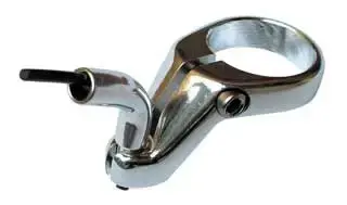

I have a little problem with sorting the front canti routing on my RC200. The canti hanger i have bends the cable outer too much for my liking, but the RC30 crown has no cable stop either.
Could i get a hanger that is deeper and would give more cable clearence for the stem, or is there another alternative?

those hangers are meant for threaded head sets to go between adjuster nut and lock nut. used with an ahead set they will apply pressure to the head set each time you apply the brake. better use one of those bolt-on hangers!
cheers, carsten
hey paul,
see the headsets in then, i use the 2nd 1 pictured on my cross bike, gives loads more clearance and the bent pipe can lean to the side if you need it to.
