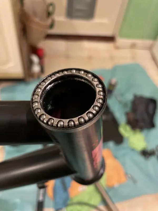

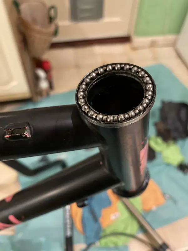

Does anyone know which way up the top bearing cage goes in a ritchey logic 1 1/8 threaded headset? I’ve attached pictures, sorry for the silly question! It’s going on a 1992 marin eldridge grade. I’m actually now thinking I might like to replace this old headset though , with something new or at least in a bit nicer condition, any recommendations ? I see you can buy a new ritchey logic 1 1/8 threaded on Amazon. Is it a case of any 1 1/8 threaded headset will fit ok ? Cheers!

Can you show us pics of the headset cup and the top bit(I don’t know what that’s called) normally it goes it’s the cage facing upwards if it’s an oversized headset (eg xt m735 era) but normally in most cases the bearings face upwards🙂
Pic 1 I'd wager is the right way or the top race will be riding on the cage. Usually.
Ok thanks , that’s the way I guessed, feels ok that way up . Think I might be missing a washer between the two top nuts though.Anyone tried the cheap new ritchey logic headsets? Looks like they’ve got a horrible plastic bit on the top but I wouldn’t have any need for that part anyway. Or any other suitable headsets ? I’m not sure if I need to worry about the stack height when choosing one?
