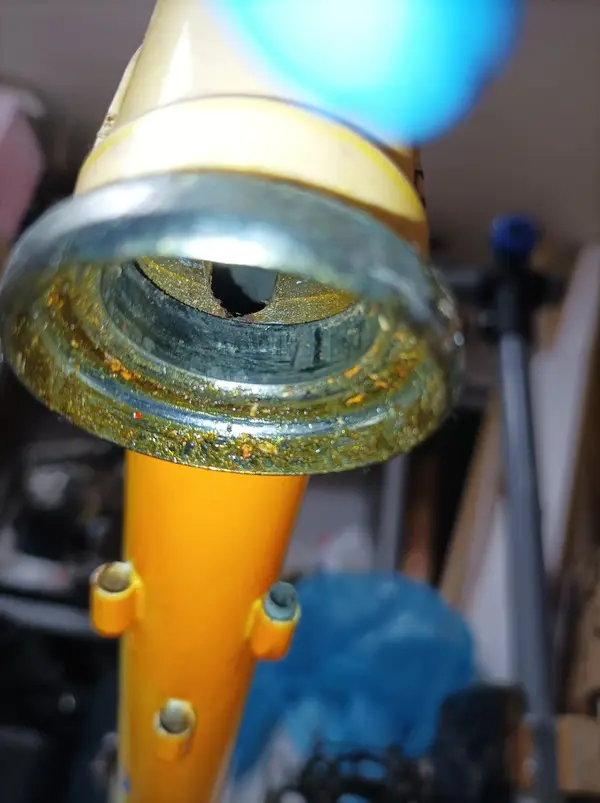

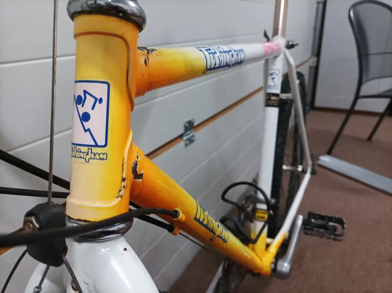

You can see theres a burr where the head tube had its hole stamped out.
This stopped the rear of the headset cup seating completely at the back. It looks like this is seamed tubing and the seam runs down the back there too.
I removed the cup and filed it smooth and knocked the cup back in. It seats much better now.

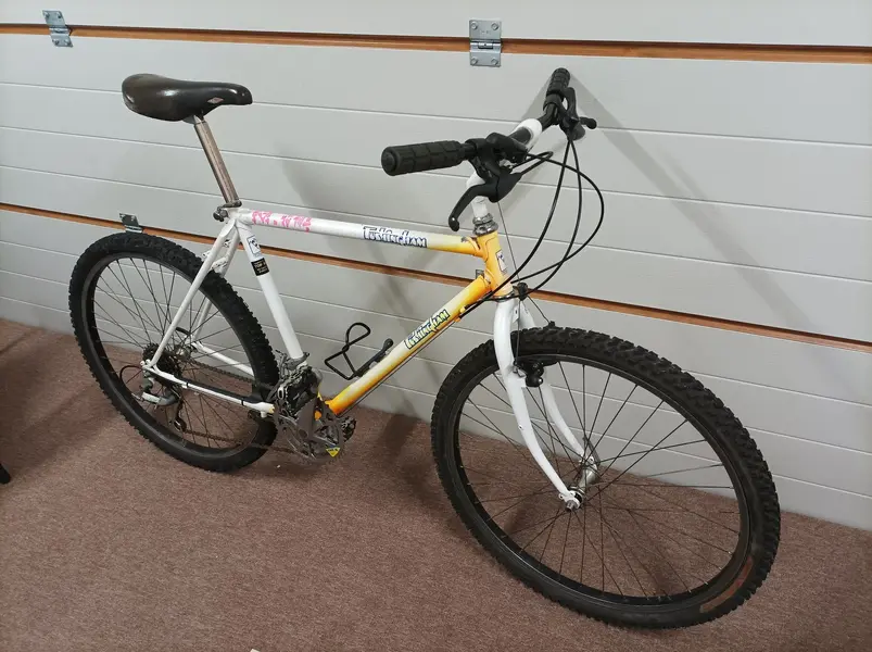

Possibly controversially I am going to downgrade this to the kit it may have come with.

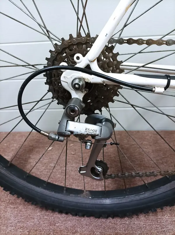

The front mech is exage mountain, as far as I can tell they were specced with that series.
So the m730 and mt62 is going.

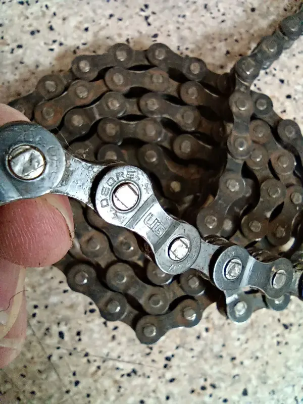

It has a Deore uniglide chain, which may be original? Unworn 12" dead between 12 links.
I doubt it was mt60? Anyway I've scored a donor with exage mountain, so those bits will go on this.
I think too often the functional mid range stuff is neglected. Anyway, the frame is kinda midrange anyway, it's not handmade in the UK nor some wonder material, just a fairly standard construction thing.
Nice bike, I believe Exage Mountain was standard spec, at least the B52 I had for a while was. Chain probably original too to match the Uniglide rear.
Looks like it's had a relatively easy retirement on the trainer at least.

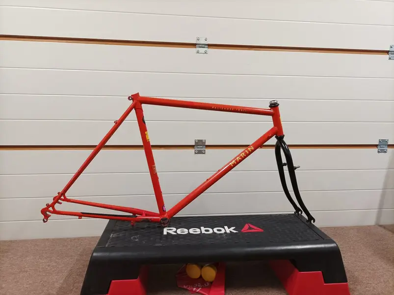

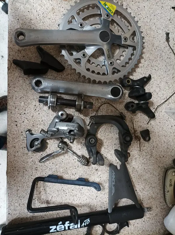

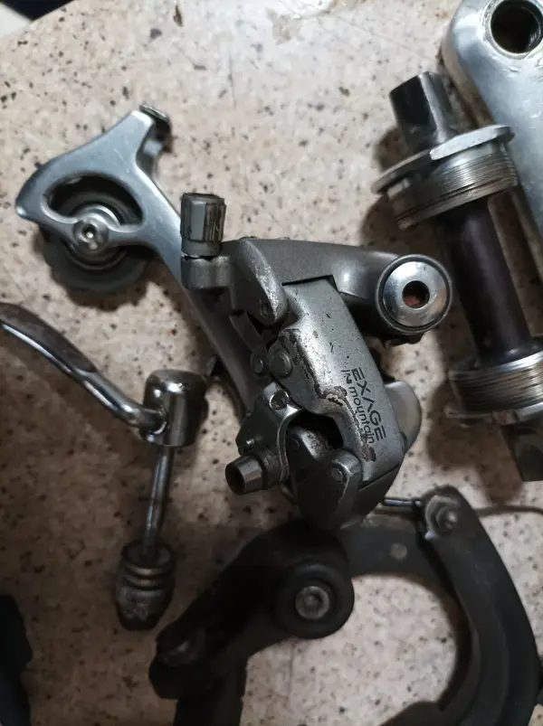

The exage doner arrived an 88 palisades Trail.
And was quickly stripped of its exage and sold on. A lovely looking frame itself.

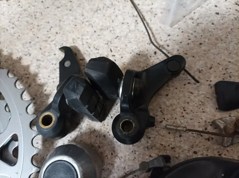

Leaving me with some juicy loot:
IMG_20220108_205853.webp IMG_20220108_205857.webp IMG_20220108_205901.webp IMG_20220108_205905.webp IMG_20220108_205925.webp IMG_20220108_205937.webp

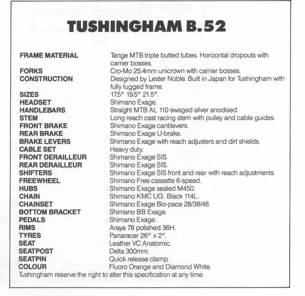

Now the original spec sheet says exage, as far as I can tell from other threads they were mostly exage mountain. This spec sheet is later than my frame I think, as I don't have b52 decals and bars are black.

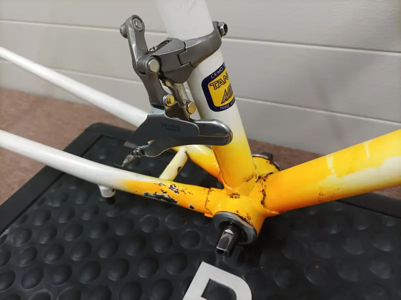

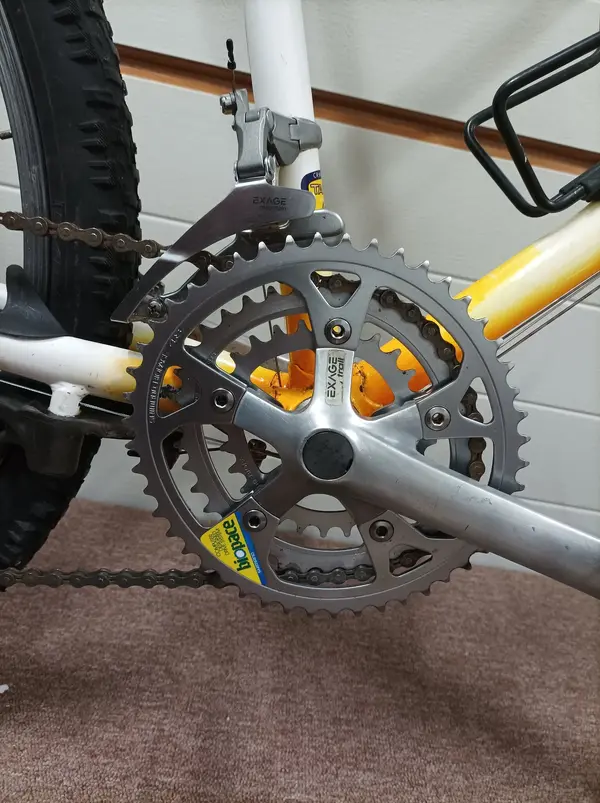

The frame came to me with an exage mountain front mech

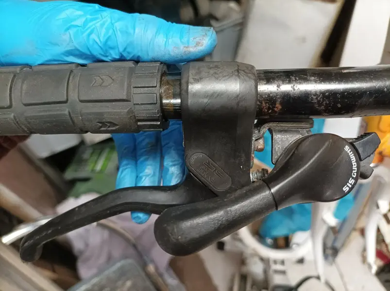

The haul from the Marin has exage mountain u brake, rear mech. The levers front brake and chainset are exage trail. Close enough I think given the rarity of exage mountain.
The wheels are black araya rims on joytech with a Shimano 6 freewheel. These will do.....

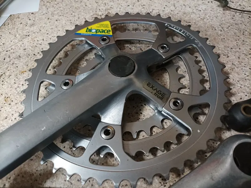

Sadly the pedal thread was stripped in the right crank, but legrandfromage came to the rescue with an identical looking 400lx chainset, the exage trail sticker was transferred.
All this exage stuff is used which matches the patina of the frame.

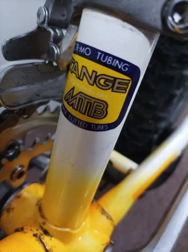

My bike is the one just before yours in the main Tushingham thread (https://www.retrobike.co.uk/threads/tushingham-resource-pool.203977/page-13). He has no stickers and very few original parts. I'm even not sure if it was build with Tange MTB PG tubes or with the Triple butted ones :rolleyes:

- What is the diameter of the seat post ? Could you see directly inside the seat tube three different thickness ?
