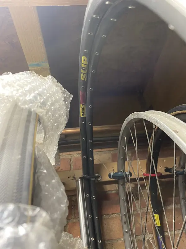

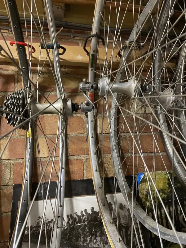

Wheels the long term intention is to build these Mavic hubs - currently on tubular rims - 96DD8D62-AF4A-441C-A508-9AEF60291F9A.jpeg
On to these clincher rims -
Changing the Sachs block for 8 speed to match the early 8 speed Chorus brifters.

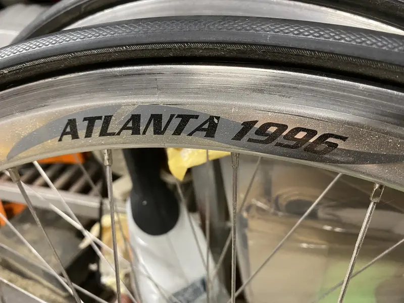

For now I’ve got these Atlanta’96 deep section rims on Exage hubs (strange combo but that’s how they arrived)I’ll form an opinion once I’ve seen them on the bike. Suspect they are Marmite, but they are spare and they have an 8 speed cassette spaced for Campag.

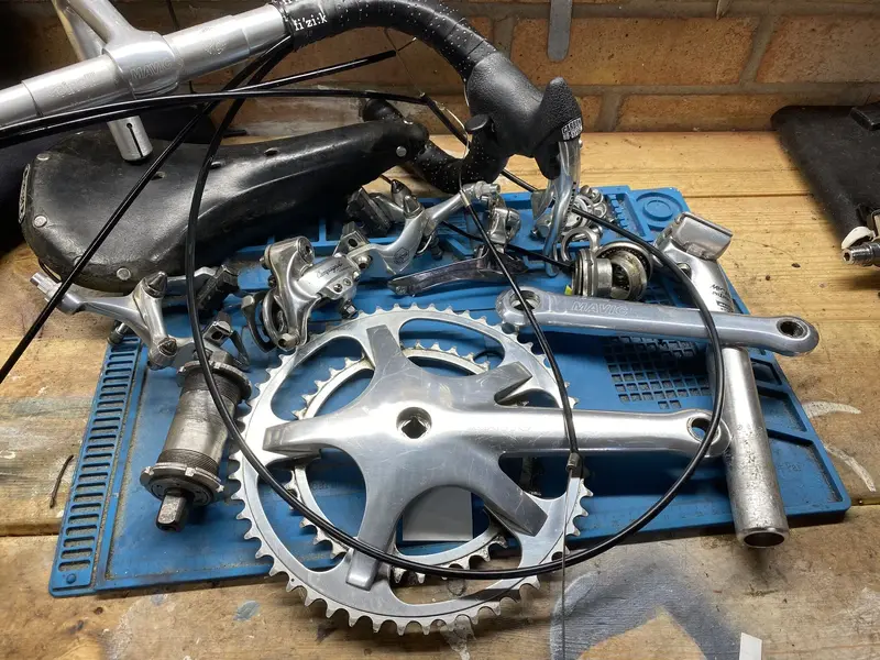

*the brifters/bars/cables/bar tape were already assembled from another bike I stripped some time ago which greatly speeds up assembly time. If I’m completely honest the cables are the tiniest bit short, if I find a set of Campag cables at the right price (these were £20 for a full set brakes/gears/inners/outlets don’t suppose I’ll see those prices ever again!) I’ll replace but for now it’s fully functional in terms of it doesn’t grab/shorten the cables, everything reaches the right place and tensions correctly. I just prefer the aesthetic when there is slightly more out showing at then front end.
