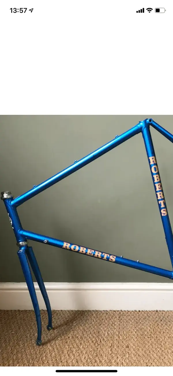

Well I’m pretty sure it is………was sold to me without any decals and in need of a repaint. From research it certainly looks like a late 80s/early 90s Roberts?*edited having researched a few more threads on here the frame number indicates a 1993 bike. I’m happy to be educated. It was cheap so I’m not bothered if it’s something else!

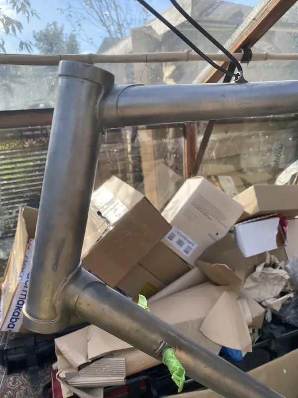

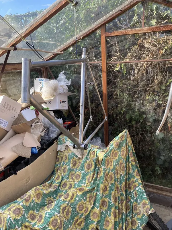

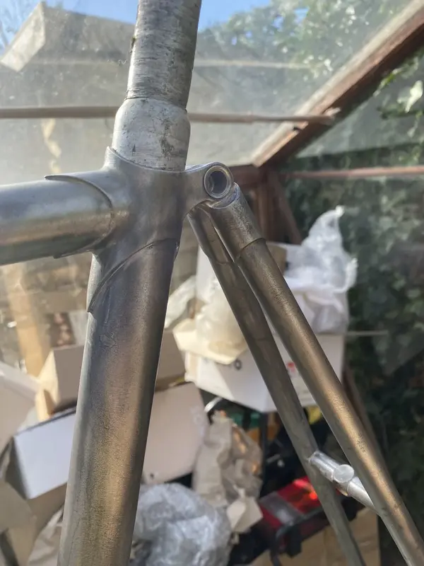

Here’s some photos of it in the greenhouse…..sorry spraybooth…..sanded, wiped and ready for primer.
8007D55E-2C0E-4B23-B3A0-BCDDB4F23D86.jpeg B697D5B8-4CBA-4336-B543-D8ADCF6BB1BE.jpeg 60F29A93-8688-4AC0-BA0D-B933DCB4DD3B.jpeg 527D9570-68B6-4FE8-B81C-CAE5A59D2DE8.jpeg
*seatpost, bottom bracket, bolts etc sacrificial items from the scrap pile to avoid me plugging the threads with paint.
Interesting seat lug?seat stay interface. Can't say I've seen one quite like that. Looks like a complete unit, lug and sockets for stays in one casting.

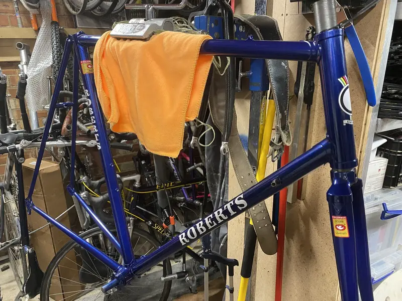

Well that all came together quickly! Enforced afternoon at home after my first post yesterday meant I managed to get a couple of coats of primer on with a flat back between coats with some 600 grit wet and dry.

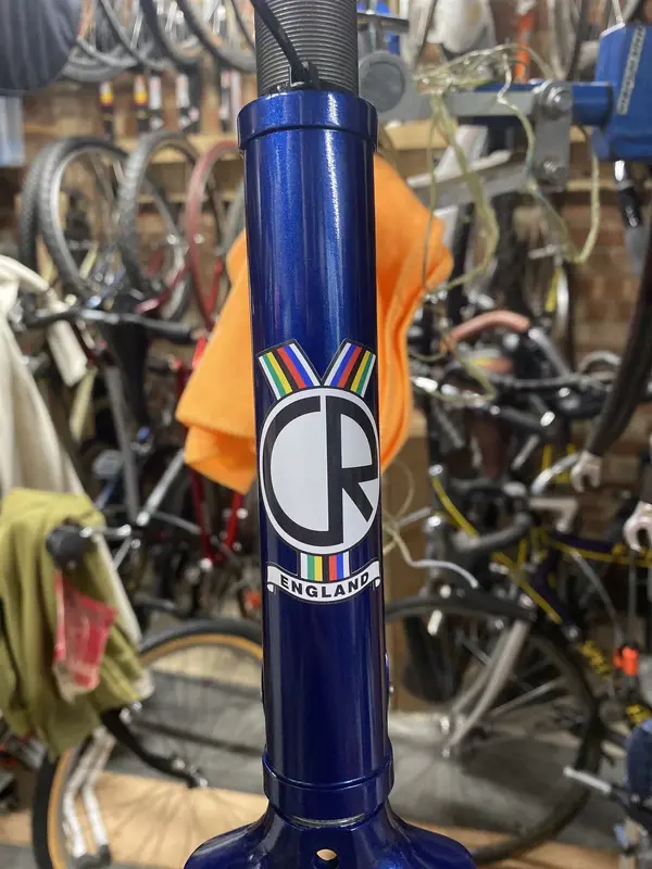

The base coat arrived first thing this morning, the primed frame having baked in the sunny greenhouse for a few hours it didn’t take long for a couple of coats of blue then another couple of lacquer to go on and dry in the sun. Couldn’t wait to get the transfers on which I did this evening back in the cave as soon as the lacquer was dry enough!
Pleased with what is my first effort at spraying a whole frame.
Are you replicating the decals that we’re on before?
As the seat tube decal looks a little small❓

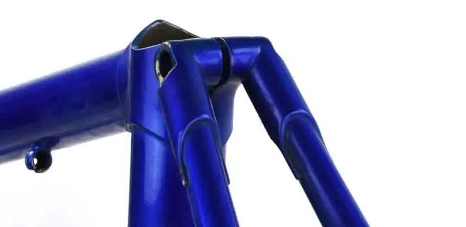

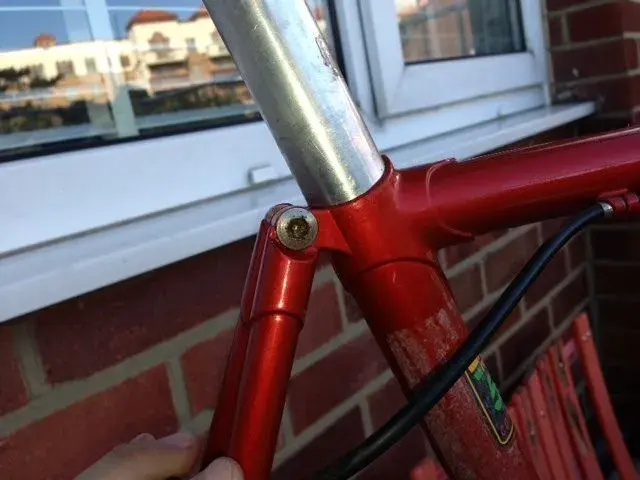

That's a great looking frame, I really like the neat fastback seat stays and clamping arrangement. Raleigh did a similar thing on its SBDU 753 frames around 89-90 using neat little caps on the seat stays attached to a cast seat lug with a decent clamping arrangement. The earlier Raleigh 753 fastback clamping was weaker and prone to failure.
Hi, it didn’t have any decals on it so I’ve gone with what I liked the look of most! I think they came from HLloyd or EBay, it was a while ago when I bought them. I just went with the set I liked the look of the most and included my favourite Roberts head tube decal -
I’ve got several bikes mostly in MTB that are “factory” and right or wrong I enjoy the challenge of keeping/getting them to the “right” spec - so it’s a bit of a fun challenge for me to work with a semi-blank canvas. I’m not known for my artistic ability or vision at home! Fortunately I’ve not lacquered the decals as I realised I may want to change them, for me it’s trial and error in this department. The set I bought had two of what I consider to be the head tube decal - would it be normal to also have one on the seat tube?

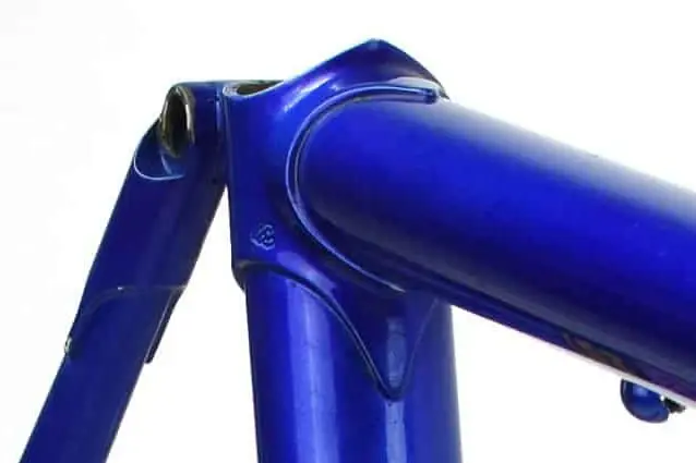

View attachment 579278View attachment 579279

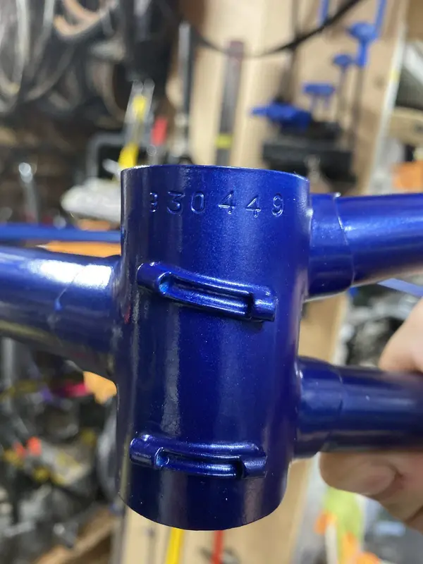

That does look very similar - are those Cinelli lugs? Mine while similar don’t have the logo on there.

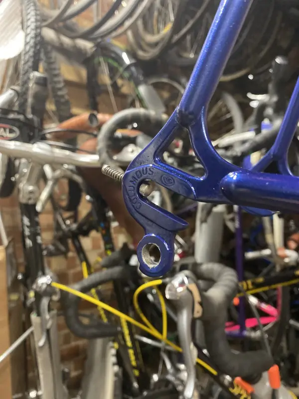

The frame numbering on mine definitely follows the Roberts numbering convention, don’t think it’s SBDU maybe someone can identify it from the number?
