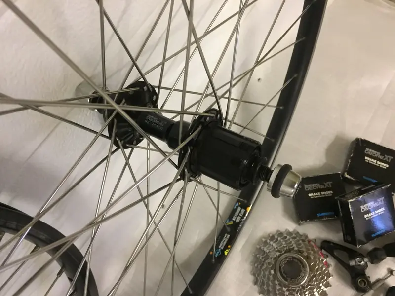

I have a near perfect set of black XT STIs and similar mint black cantis, plus a set of NOS XT thumbies (if I decide to really go outside my comfort zone).. but any black chainset that does materialise is pretty beaten up. Hubs seem rarer still.
Ha. That news bodes ill for my proposed build..

Hm, black hubs may not show the same wear, but they always appear in the wrong variation. 32L when you need 36, 135mm when you need 130mm. And then there seem to be different definitions when the bearings are "smooth".
