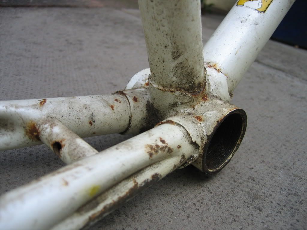

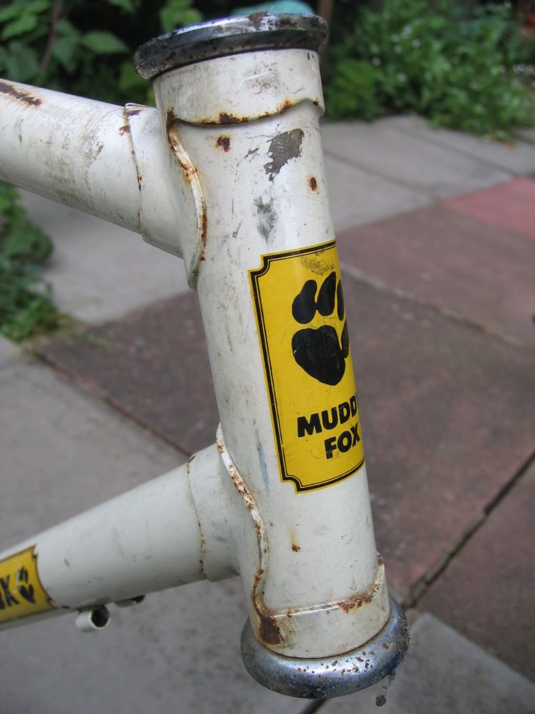

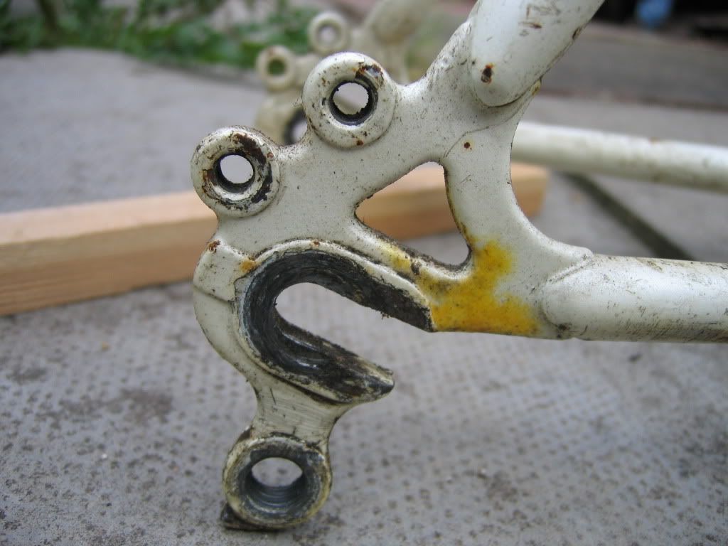

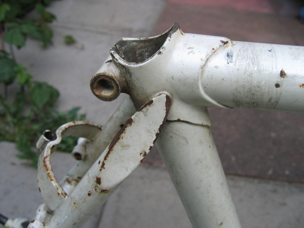

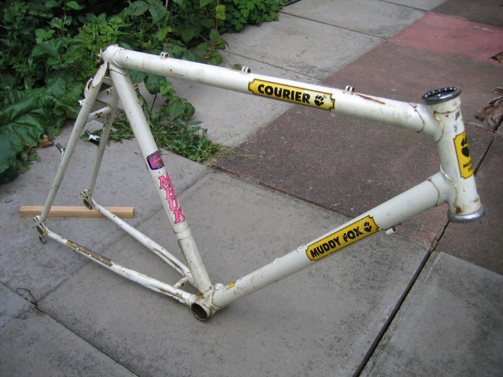

OK, so it's more than a year later and all good things start and then fade off :) Anyway, I'm back and I've stripped the bike and have been sourcing some bits for it. Excuse all the pics...
Here it is completely stripped - first bike I've ever stripped. Created my own headset cup remover (piece of copper piping!) to remove the cups - works brilliantly. Shame to lose the retro pink MBUK sticker in the respray though!

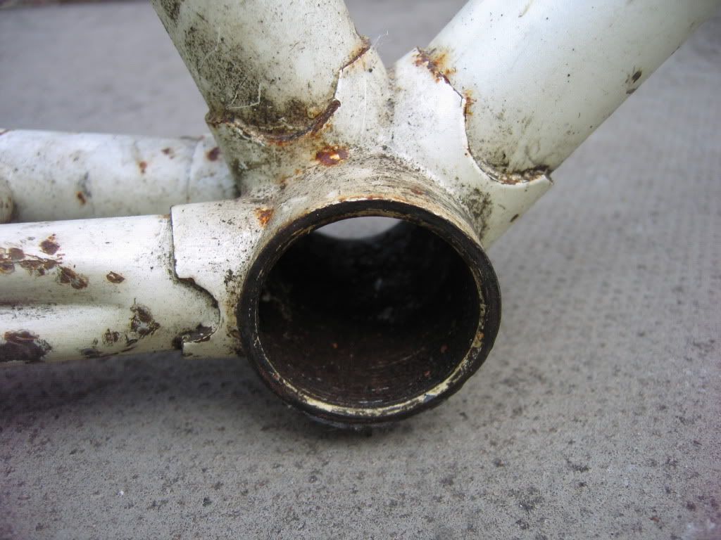

The frame is in a bit or a sorry state (my fault - I've neglected it for the last 10 years or so) - this is before the cups came out:
Seat post came out quite easily:
As did the bottom bracket:
Next job is to send it off to for a powdercoat. Gil_M has already created the decals for me, but I'm missing the pink Tange sticker, so have taken lots of pics of it.

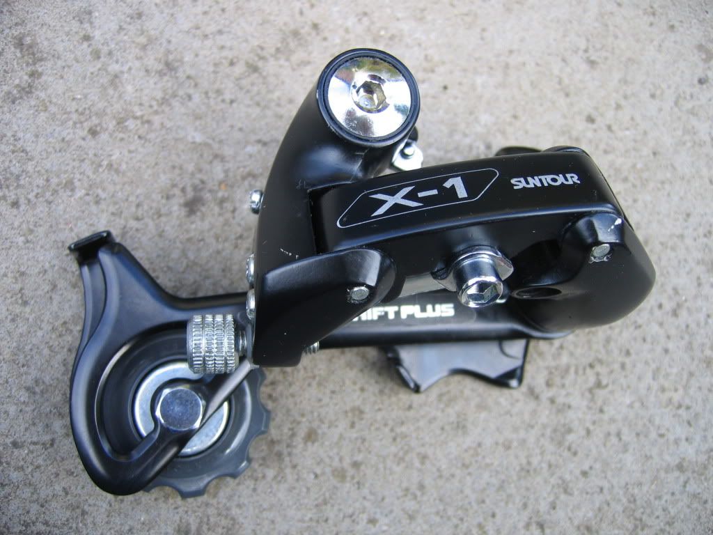

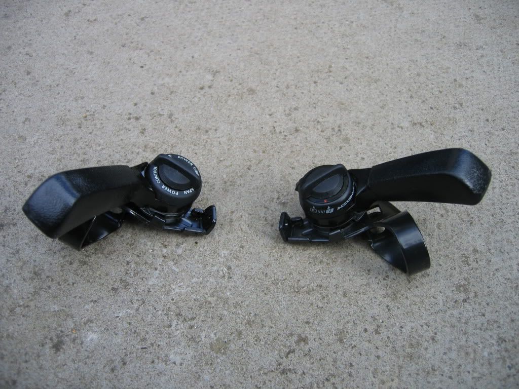

In the mean time I've been sourcing bits. I've decided to go down the Suntour route building it up with some nice period NOS Suntour X-1 (middle of the road parts) that I've slowly been collecting:
NOS front derailleur:
NOS 7spd Accushift thumbies:
Mint rear derailleur from the sales forum (thanks Stu!):
As regards wheels, hubs etc. I had a bit of a ponder. The rear dropouts are 126mm so that leaves me with fitting 126/130mm hubs. Not searched too much, but don't see much about. Anyway, I've decided to overhaul the old hubs and put them on new rims (the old Araya rims were in a poor state as the braking surface was curved :shock: ). The cones and races dont't seem to be in too bad a state thankfully.
